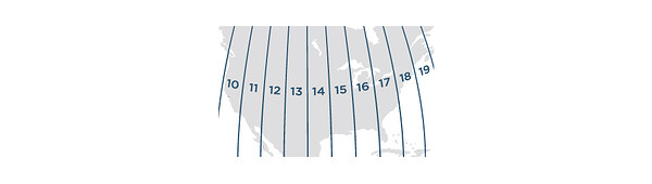

Zoning
As we can see from the name of the projection, it can be used anywhere on the globe. This is possible by dividing the Earth into 60 zones using 60 central meridians which serve as reference points. Each zone is 6 degrees of longitude, or 668 km wide, which allows for minimal distortion within it. Zone 1 is located around the Alaska area, Zone 60 is in the area of New Zealand.
Thanks to this zoning, you can use the same projection across the whole territory of a large country—just pick up the right zone. Otherwise, it’d be impossible to create a projection which will fit all the parts of the country and feature only minor distortions.

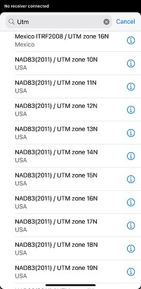

UTM and Gauss-Krüger projections in Emlid Flow
In the Emlid Flow app, there are numerous coordinate systems with UTM and Gauss-Krüger projections. To select the right one for your project, you need to know in advance which zone you are in.
Also, if you don’t know exactly which local coordinate system to use for your project, it’s worth choosing one with the UTM or Gauss-Krüger projection. They allow working in meters/feet, the main reason you’re looking for a projection for your area of interest. Besides, you can easily convert any of them to other projection when necessary.
