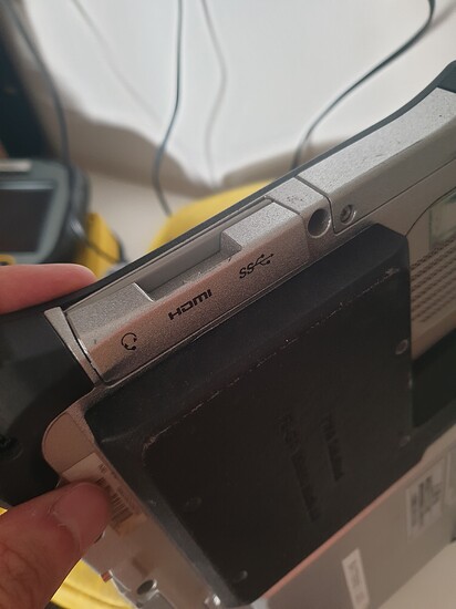

What can be done next is to upgrade the opening system in terms of both size and material. Maybe even the opening system can be redesigned. As an example, we have equipment from other brands that are all designed for outdoor use. And we haven’t had any problems with the protectors getting lost.
Here are a few examples, and on intrument like total station the cover are usually in solid material with hinge.
