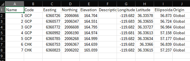

Thanks for the reply. I do get Emlid Studio to work if all columns are in the csv file. Then I would lose the northing, easting and elevation columns in the corrected one. I figured out that by reimporting the .csv back into a new project in Emlid Flow, then exporting it again, I could get the northing and easting back but the altitude gets changed to ellisoidal instead of feet. That is my current problem now.

For those PPK’ing your GCPs with “Stop n Go” in Emlid Studio, what is your workflow once Emlid Studio gives the corrected .csv? The Easting, Northing and Elevation columns are empty and the only elevation is in ellipsoidal heights. It’s a bear trying to get a workaround to get that back in easting, northing and orthometric elevation in feet. How are ya’ll dealing with this?

Hello, I’m still having a problem with **Stop 'n Go PPK in Emlid Studio. It deletes the ENZ columns but I fed it back into a new Emlid Flow 360 project with the same settings and get back the E,N columns but the elevation is different. Don’t know what to do about it and thinking about skipping it all together trusting the RS3 is 10 sec. averaging my GCPs well. Check out the screen captures.
Any help to get the elevation to be the same (but corrected) as the original elevation would be great. Thanks in advance.
