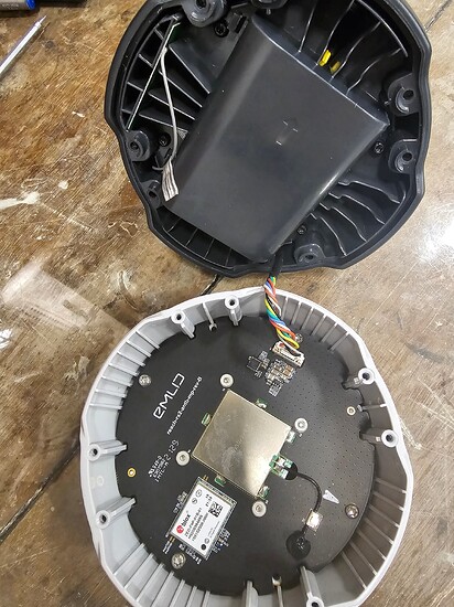

I did several procedures tring to recover it, one of them was rollback to previous firmware using Reach Flash tool, back from v32.2 to v29.2, surprisingly, the behavior changed, no more flashing lights forever, after 3-4minutes of reboot it stop flashing and got a solid light, went to the app on cellphone and it start to perform check test and failed on test 2, I think test 2 means hardware but I’m not sure about that. After this, there is a option to generate and export report.
When I check the logs, in a file called reach-self-test I found this error:
" ERROR] — Antenna board is not connected (self_tests.py:56)"
I opened it, check cables connection using a multimeter, maybe it was just a connection issue duo to hot/cold changes,
but cables are ok, probably my antenna board has gone and I had to replace it. One think I can do it´s test using another antenna board from a working RS2, let´s see what´s comming next.

I saw a post awhile back about the physical antenna (below the dome shell)(other side of board) coming apart at the solders i think… I’ll look for it. Maybe disconnected at that point.
Try @ceith too for parts if need be.
Maybe of the 4 connections… 1 or some broke if entire antenna isn’t lose rattling around.
