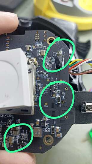

I sent the unit for repair in a authorized dealer. After strugling for 2 weeks the guys sad they found oxidation components in the main board (not antenna board).
So, that´s a certified IP67 unit,it should handle 1m above water level. It got damage after a 1 single rain it took.
Also, dealer support sad: “we are not capable to change or repair since the main board costs 50% of the unit”.
So, thumbs up for Emlid again not been able to repair the damage caused by their negligence on “certified” IP67 products.

Hi André,
Thanks for sharing these additional details with us! I’ve also seen the photos you shared with me over email today, and I totally agree that an IP67-rated device should be able to withstand rain. The situations might differ from case to case, though; for example, sometimes, the protection might be compromised by physical damage or other external factors. So, we look into the specifics of each situation separately. Still, we can see you treated the device with care, and it seems like there are no other factors that could have affected the unit this way.
Considering all the context, we can agree that’s not how it should work, so we’d like to make an exception and replace this unit for you. Even though situations like this, when moisture gets inside the unit, are extremely rare, I’m sorry it took so long for us to get the full picture and reach this solution. I’ll email you shortly with more details about the replacement.
