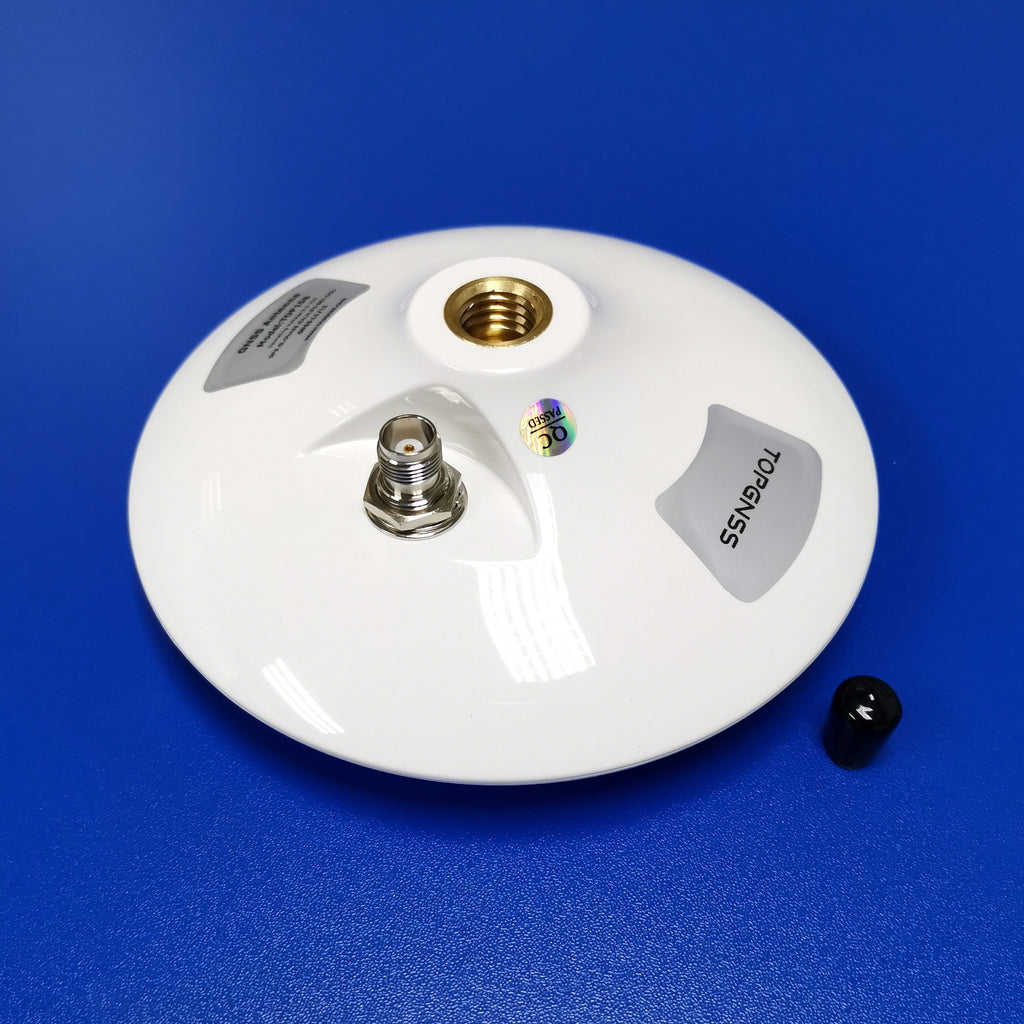

I use the (2) TOP106 which is calibrated also with 2 M2’s. Works great!!
