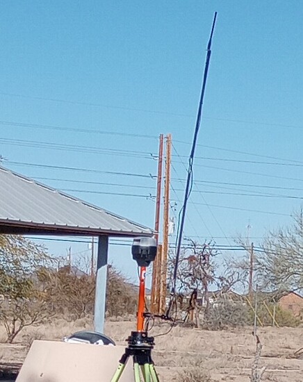

A simple antenna riser solved it for me. Now I stayed fixed at over 2000m.
