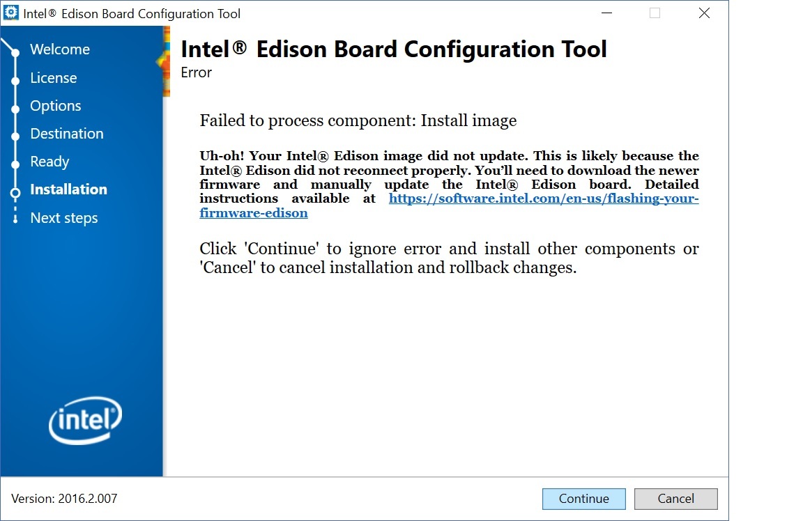

Reflash failed with an error on Win10 64bit. The toolchain works since I can flash the edison original (most recent default image). If I try to flash on the top of that it seems to do the emlid install, but when reach shows up as a wifi hotspot I am unable to connect. I reflashed under OS X, it seems doing the same thing. (reach shows as wifi, but when I connect to it it does not even ask for wifi password and not possible to connect).
I also tried with flashall.bat and ended up the same: reach shows up as a wifi hotspot, but unable to connect and when I look it up on the Edison Board Configuration Tool, it says firmware version not detected.
