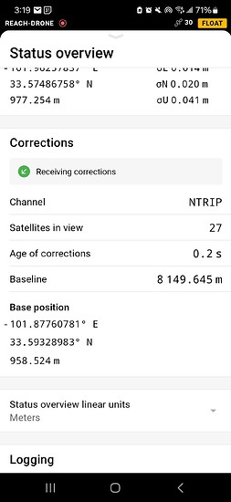

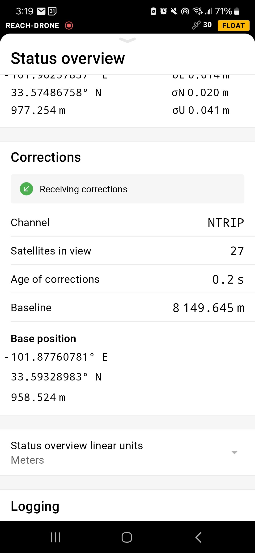

For my parameters on MP, I just strictly followed the parameters changes from the article I sent before, so if you need to know, just look at that article. For my Emlid flow, see the screenshots for my setup there.

I don’t understand how the corrections are not injected into the telemetry. The M2 was connected to internet via my phone hotspot (2.4hz). My correction input was set to my NTRIP profile. The profile name was caster because I thought the profile name was just there for you to call it whatever you want. No, I do not have my own base. The position streaming was set to serial when this happened. Yes, the M2 is receiving corrections, see the screenshot for more on that.
