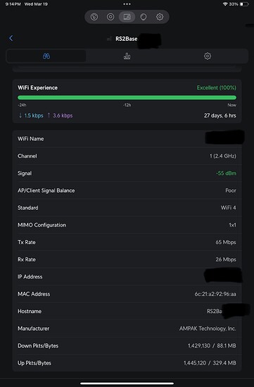

So my screenshot is pretty close then.
I don’t know how you all are using such little amounts of data. My testing reports much higher values.
