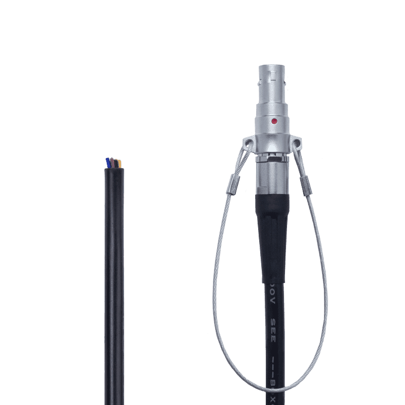

I solved this problem and everything works. In case anyone needs a ready-made solution, I provide a working sceme.
You will need the following, USB Type c to Rj45, BATTERY CHARGER 12V 1.5A and Reach cable 2m w/o 2nd connector (see attached screenshots) Connect USB Type C to your Reach Rs2/Rs2+ and to Lan, thereby your device gains access to the Internet . Open end Reach cable 2m w/o 2nd connector connects to BATTERY CHARGER 12V 1.5A. The violet wire is to the +, and the red wire is to the —.
Everything works in this scheme. I wish you all success!
