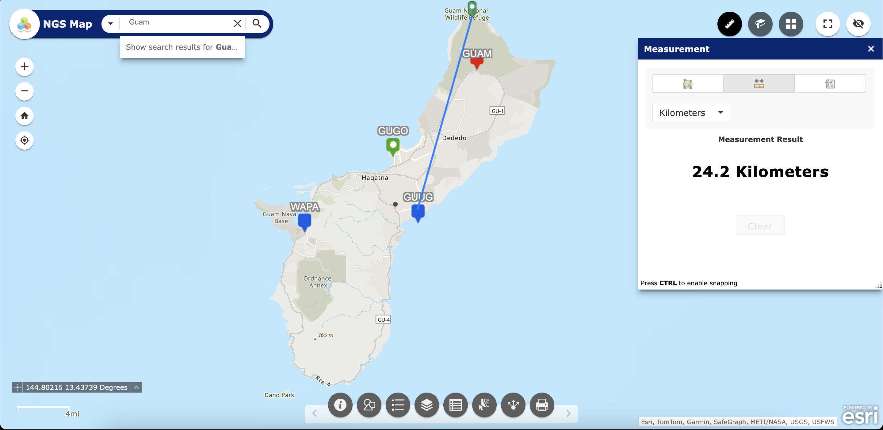

The other 2 CORS are within the recommended baseline, GUUP and WAPA.
It’s also worth checking these two, as their sampling rate is 1 second, which is way better than the GUAM base.
So you recommend to record at higher rate, ie 5 Hz and use GUUP and WAPA as bases?
I’d recommend recording at a higher rate, at least 5 Hz. As @jbonde002, recording at a higher rate in this environment might result in noisier data. However, you can always use Emlid Studio’s Convert to RINEX option to decimate your data into a smaller sampling rate.
For the base, it might be worth trying all three and comparing the results afterward.

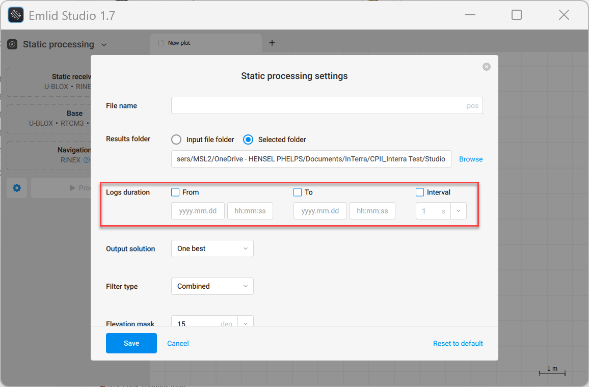

I always save recordings in Rinex. Is there a tutorial you would particularly recommend that explains how to decimate data from 5 to 1 Hz in Emlid Studio ?

You can set the timeframe and intervals in Settings.
@survey,
This guide doesn’t show how to decimate the logs, but explains how to use the Convert to RINEX option.
You need to change the interval there.
PS.
I forgot that there’s also an option within the Static and Kinetic settings. Thanks @michaelL, for pointing that out!
So if I log in 5 Hz mode and then I set the interval to 1 s (as shown on the screenshot @michaelL provided), that would do the 5 to 1 Hz decimation?

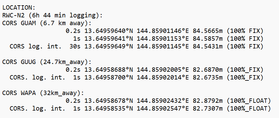

Managed to process the date of a point that was logged for almost 7h.
The results depend a lot on the CORS station used. The closest one (6.7 km away) has a logging interval of 30 s, the other two 1 s. The logging interval (set in Emlid Studio processing settings) of the receiver doesn’t affect much the result (cm level), but the used CORS gives a major difference (2 m!).
How can I estimate which correction is more reliable?
P.S. I assume that the logging interval of 0.2 s equals 5 Hz?

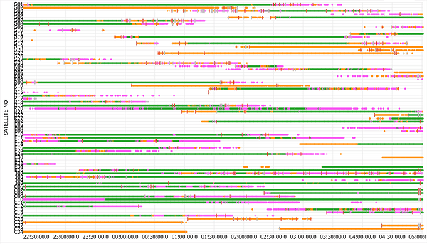

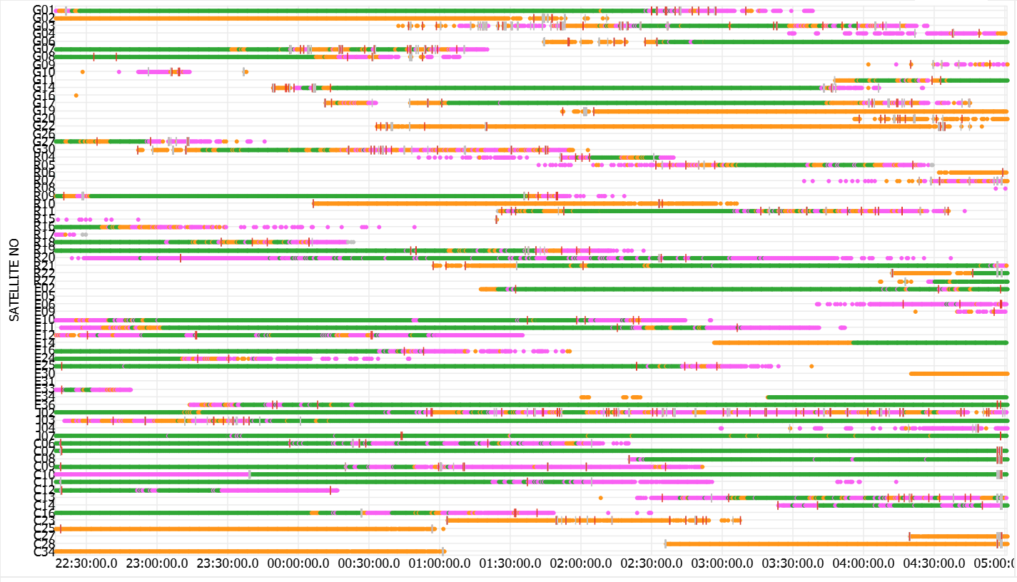

Could you share the raw data logs so I can check the quality? Thanks!
OK. Just let me know how you check the quality so that I can do it myself for all the other points afterwards.
Oh, the system won’t let me upload the raw data files … Lemme send you a link
Thank you. Here’s a guide on how to assess the quality of raw data.
Here is the link. Let me know if you have problems accessing the file.
RWC-N2 23_5 UTC 22_16 6h 45 min

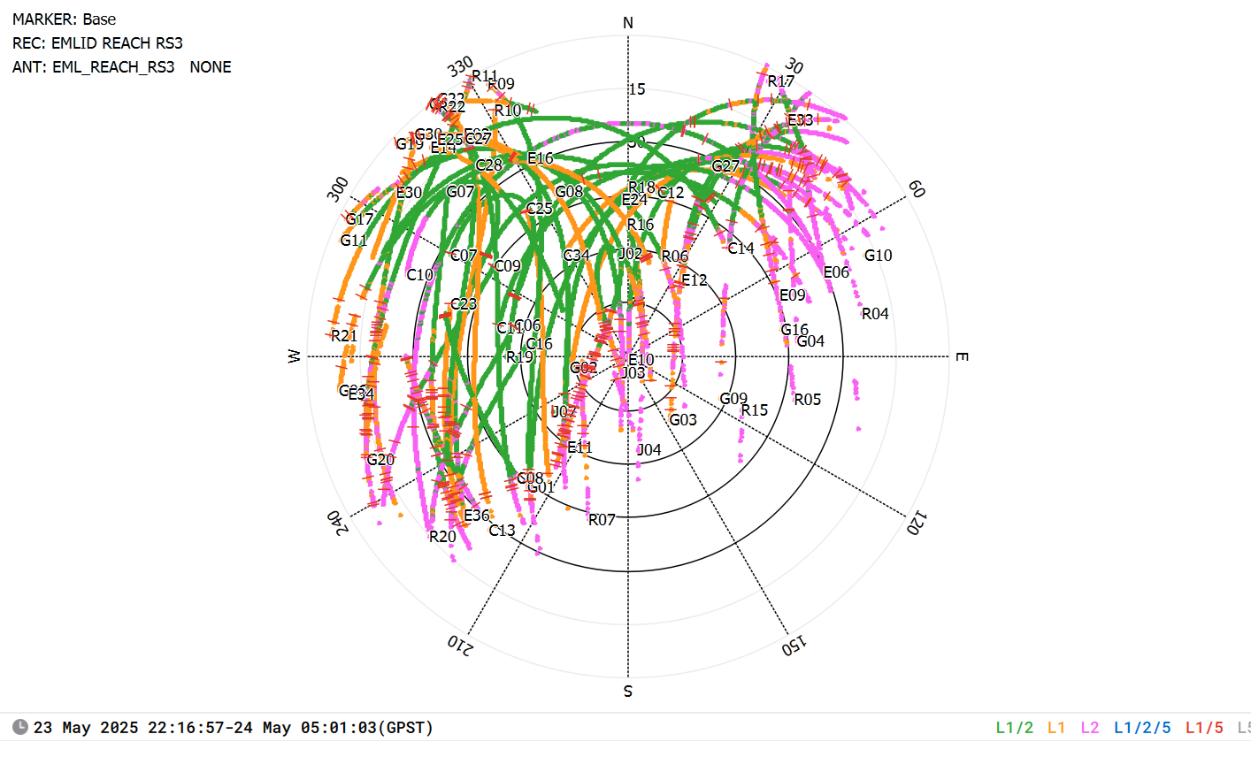

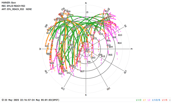

According to the guide that you sent, the quality seems to be OK; not many cycle slips and all the data has a SNR value above 35. The only thing is the satellite distribution - half of the sky is missing satellites, which was expected with the given cliff proximity. Anything else?

I know it is surprising they didn’t pull the three closet CORS stations, but that is typical of the the results they produce, at least it has been for me.
I have also submitted again to them manually choosing the three closet CORS stations, GUAM, GUUG, and also WAPA which they have rejected saying this:
