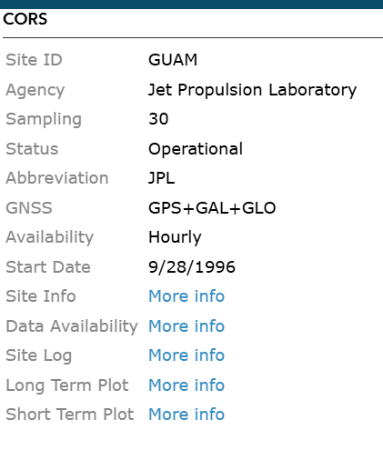

Now you have a CORS as a potential base. What rate does it record at? If it is a 30 second base that would be on the slow side - though it could still work. If it records at a 5 second rate that’s better for your situation. At 1 Hz I wouldn’t bother with your own base - at least from a speed perspective though shorter baselines always help some.

I think it records at 30 seconds, if that’s called sampling (see the attached pic.)
