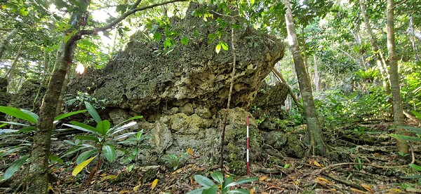

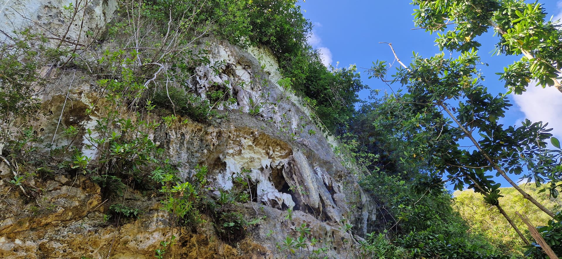

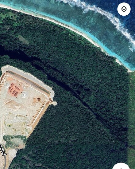

During dry deason it’s not super thick, more like some Mediterranean forest and it may have some semi-openings. Attaching the most challenging area satellite view and examples of the forest. The mentioned benchmark is in a wide open space. Id need like 5 points in a span of 3 km.
Maybe cell service in what appears to be Guam refuge area? Or Starlink? Set base on known point (MANUAL) try LoRa and see what you get… if unsuccessful, PPK Stop & Go or use cell/Starlink and use CORS with ROVER only or set base on known point, MANUAL POINT, then send corrections via NTRIP from base to rover. Or CORS to BASE (AVERAGE Fixed, save point manually) then to rover via ntrip.

Thanks for the pictures. It seems like a LoRa connection would be challenging here. Is there a stable internet connection in this area?
Also, the last picture shows that achieving a FIX solution might be challenging as the trees block the view of the sky. These obstacles will likely result in multipath and cycle slips, which would affect the accuracy of your survey.
Yes, no internet in that area. It would need to involve some post processing technique imho. And the selecting the proper acquisition time the challenge. But wanted to have more input from experience of other Emlid surveyors or the Emlid Team.
