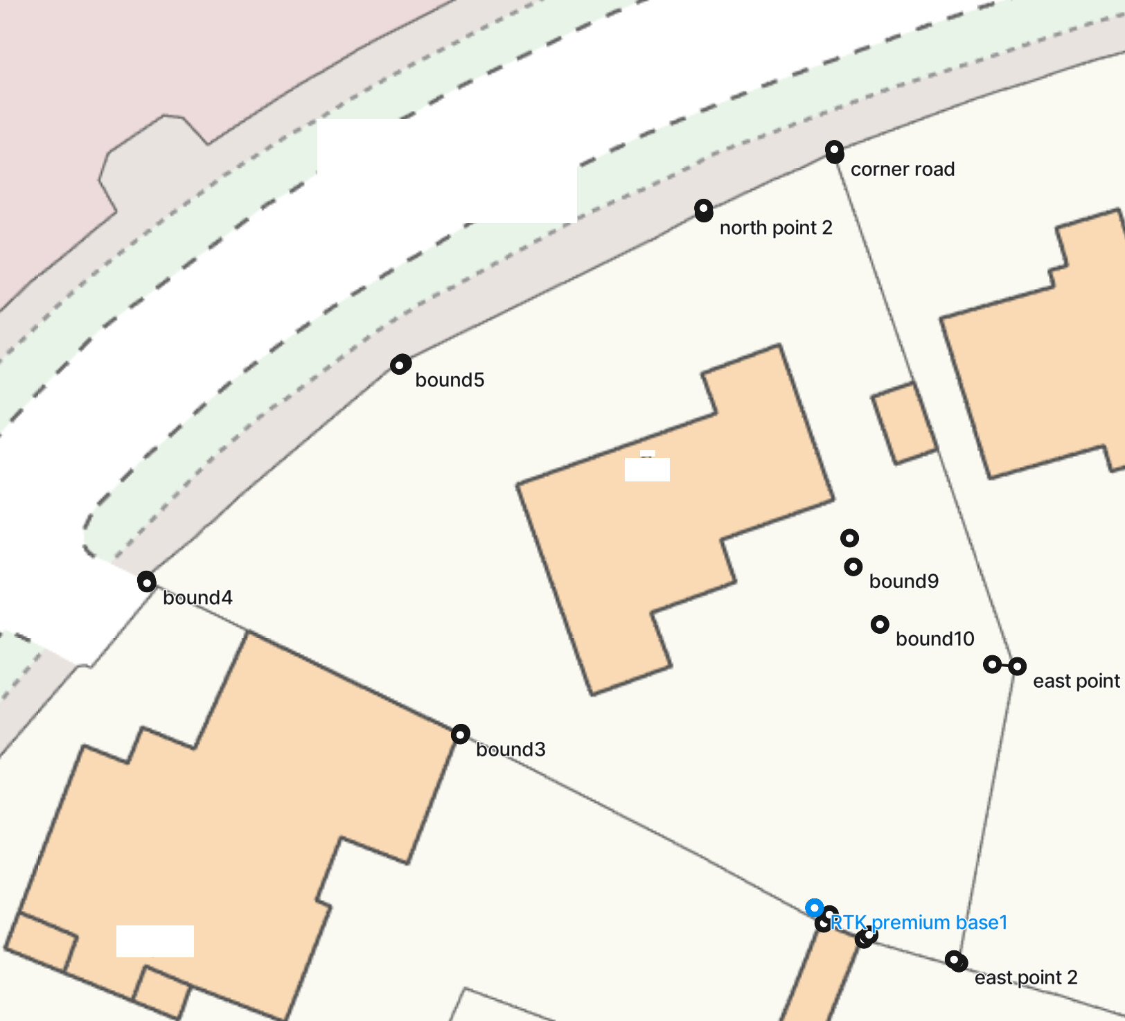

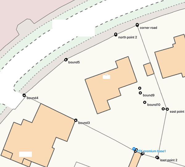

Here is a boundary check I have done (with some “personal” details removed)
I imported hard corners from Councils “Planning Map” based on OS Maps - did a survey close to the points with “standard Flow Map” - about 2 weeks ago.
Today I loaded the Road layer from OS maps and added it - result below (Please do not publish for marketing/advertising…)
Oh, wow! Thanks for sharing the results of your tests. It looks great. The road layer seems to have been neatly overlayed with the points.
