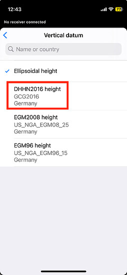

(EPSG 25832 and GCG2016 is the correct setting for Flow.)
By the way…GCG2016 is not in my list of geoids in Emlid flow.Do I have to import it somehow?
GCG2016 is the geoid used to transform the heights from ellipsoid to DHHN2016 height. So you should be good to go.
I have configured everything as shown in the screenshot.

We were able to sort the problem out.
The orthometric height can only be found in the ‘Survey’ section close to the values for Easting and Northing.
The ‘undulation’ was the perceived difference between the DHHN2016 height and the WGS84 ellipsoidal height.
