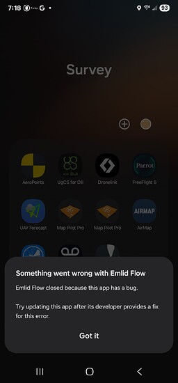

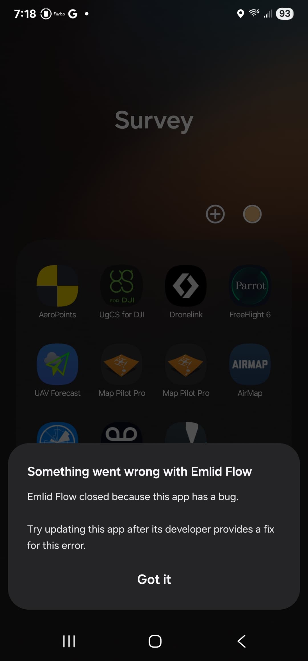

I’ve opened the Emlid Flow app several times and waited a few minutes before tapping ‘Survey’. If I scroll, the app closes. If I don’t scroll, but tap the triple dots at the upper right of a survey and select ‘Export’ the app freezes with the spinning wheel turning indefinitely. I’ve uninstalled the app, and downloaded and installed a fresh version. Now, the app shuts down immediately when I tap ‘Survey’. I’ve attached a screenshot of an error stating there’s a known bug, and I need to install a new version of the app once the developer has made a fix to the known bug.

Michael, I’m truly sorry for all the inconvenience this update has caused you. Our team is actively working on a fix for this issue and will release it as soon as possible to prevent further disruptions. I’ll keep you updated once the fix is available.

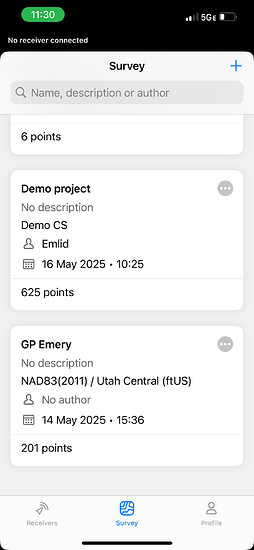

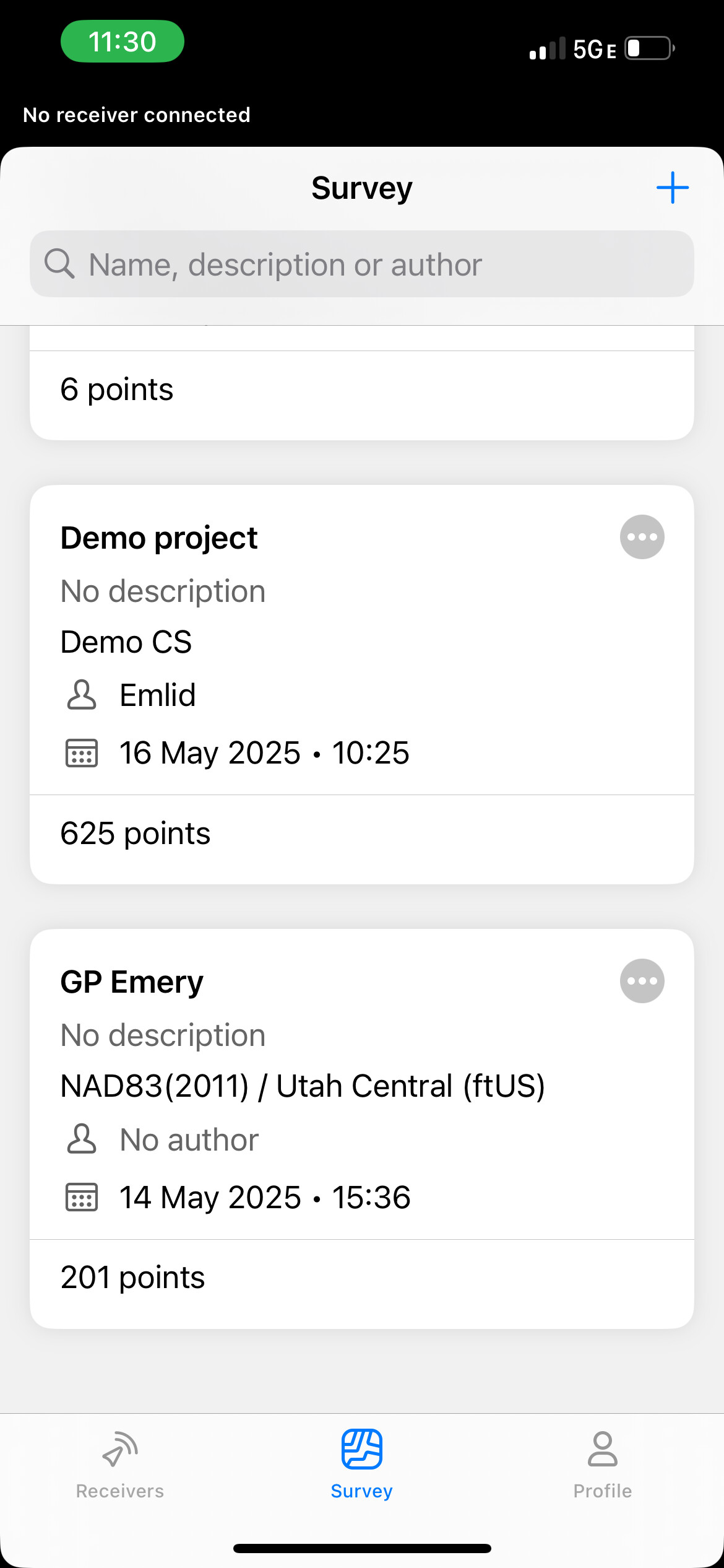

The Emlid iOS app opens and I can view the ‘GP Emery’ survey listed, but cannot see the survey or export it. It does list 201 points (see attached). It seems with export function cannot sync with the server and it stalls indefinitely. I need to recover and export the points. Is there a location on my phone where I may access these points directly without going through the export process?
