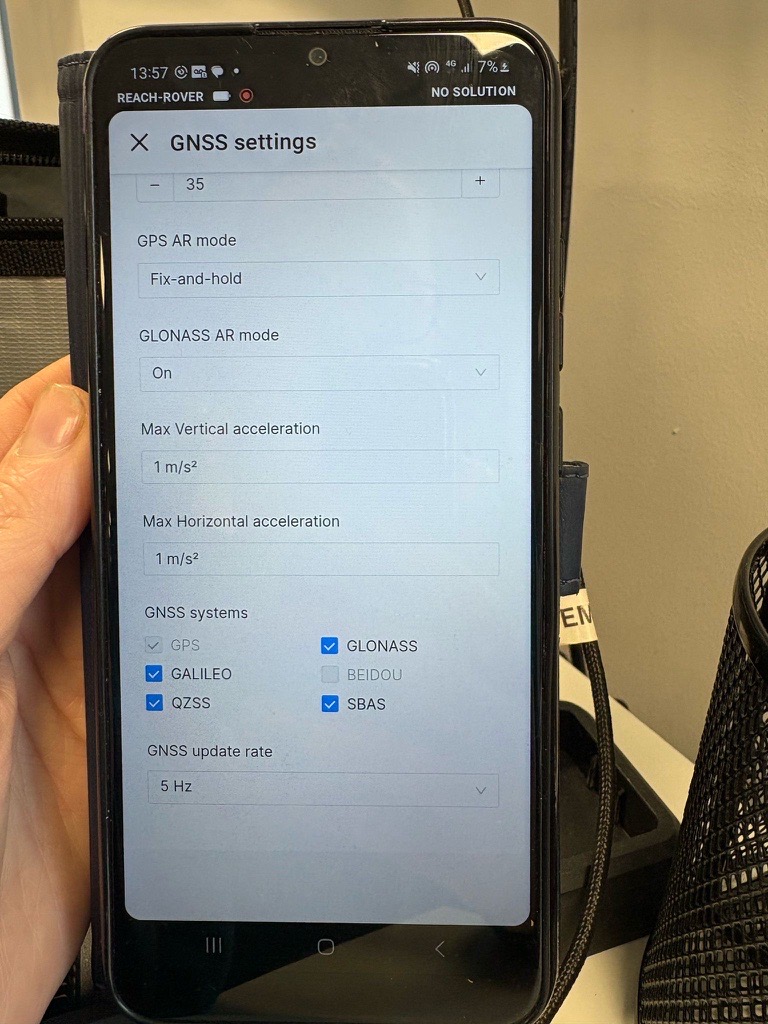

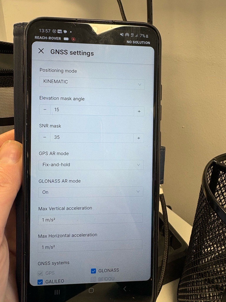

These were the GNSS settings we used as per the instructions on the emlid website:

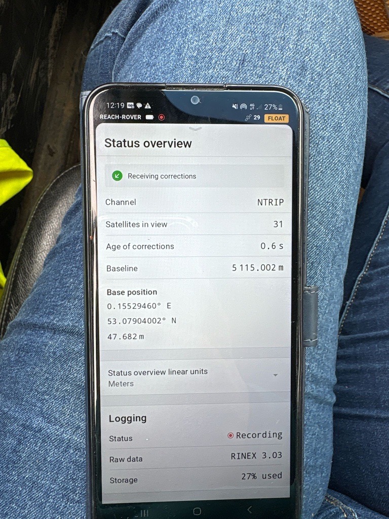

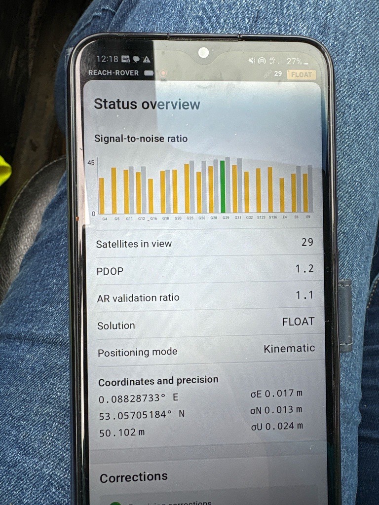

It instantly began to show it was receiving corrections and I had it on for over an hour but I couldn’t get it to change from FLOAT to FIX.

You need a dual frequency receiver to take advantage of quicker convergence times along with better data.
Single frequency is fine but there are long convergence times for fix and you need to have absolute clear skies for a reliable fix.
Turn GLONASS AR off
I can see your position quality is all under 30mm so it should get a FIX, I think it’s just something to do with GLANSS AR as the receiver hardware is different to what the VRS bases would be.

Regarding the issue of not getting a FIX solution, I would also try turning off QZSS satellites to see if it helps. Also, did you, perhaps by any chance, record the raw data logs during the test? If so, could you please share them with me?
