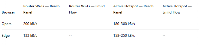

Hi, I have conducted speed tests and summarized the results in the table below:
Notes:
The dashes (“–”) indicate that in the Emlid Flow mobile app, the download speed and estimated time remaining are not displayed, so I could not record these values.
There is no significant difference in download speed between Router Wi-Fi mode and Active Hotspot mode. The speed is approximately the same in both cases.
Regarding downloading via Emlid Flow, there is an inconvenient issue:
The app does not display the current download speed or the estimated time remaining.
When downloading large files, it is impossible to minimize the app. If the app is minimized during a download, an error occurs, and the download fails.
Connection method:
Router Wi-Fi: slightly more stable speed, but still very low.
Active Hotspot: download speed 1.5–2 times higher compared to Router Wi-Fi, but still too slow for large files.
