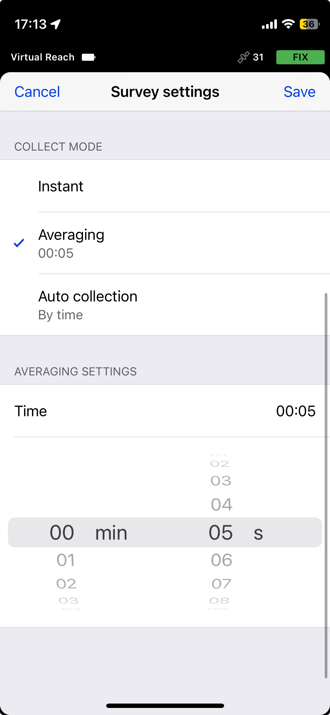

The averaging start is the time when you start on average of a point while the averaging end is the time when it finished, you can set this on Emlid Flow:

The averaging start and end times are the times when a point is collected. They are taken from the phone time and related to some part of the epoch time in the RINEX file.
