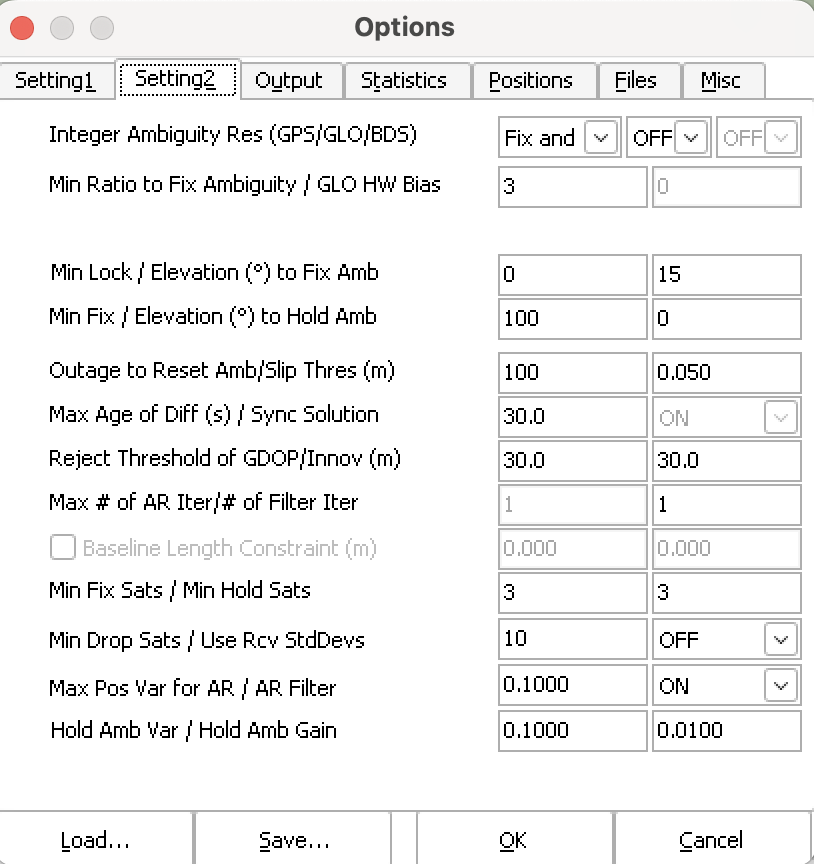

These are the results from rtkpost and plot + the settings:

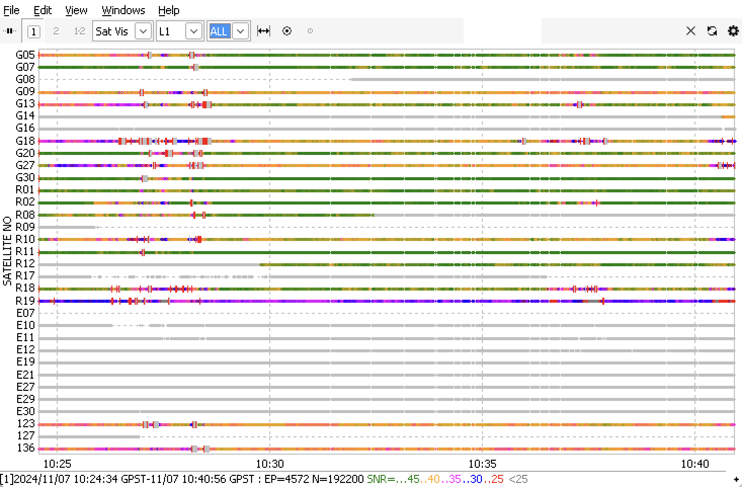

I suggest using Emlid Studio, as we support this event processing feature, and try changing your processing settings. I can see that the data is quite bad, which is probably why you get the event’s position scattered around.
Emlid Studio is compatible with any receivers’ logs, as long as they are in RINEX or UBX format.
Please refer to this guide to help you assess the quality of your data logs.
