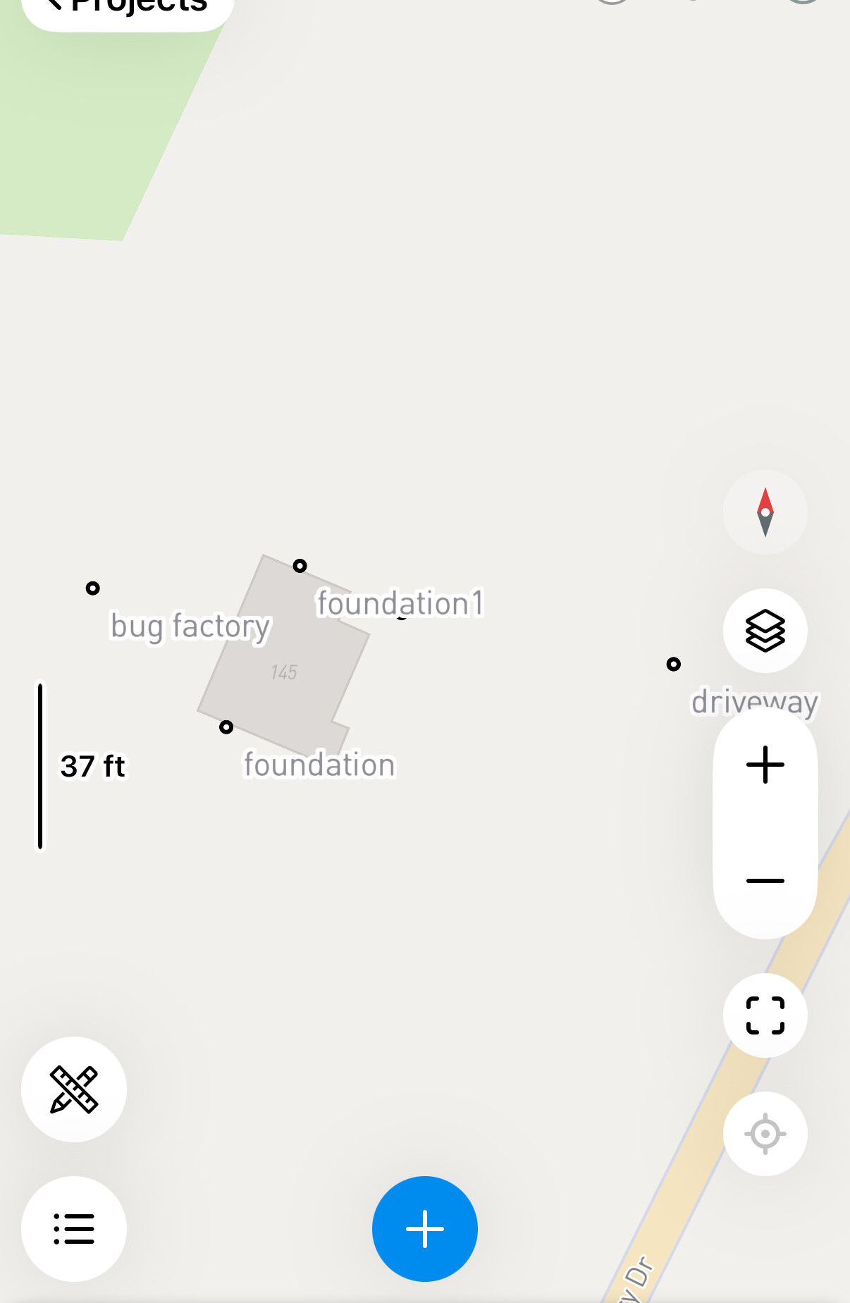

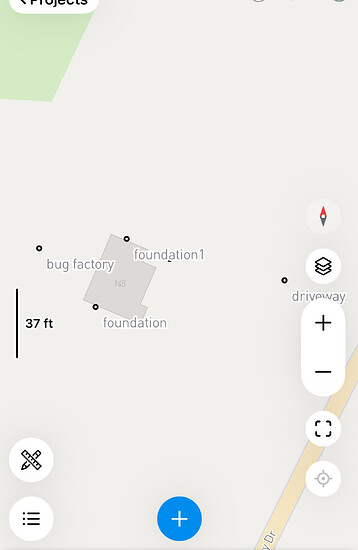

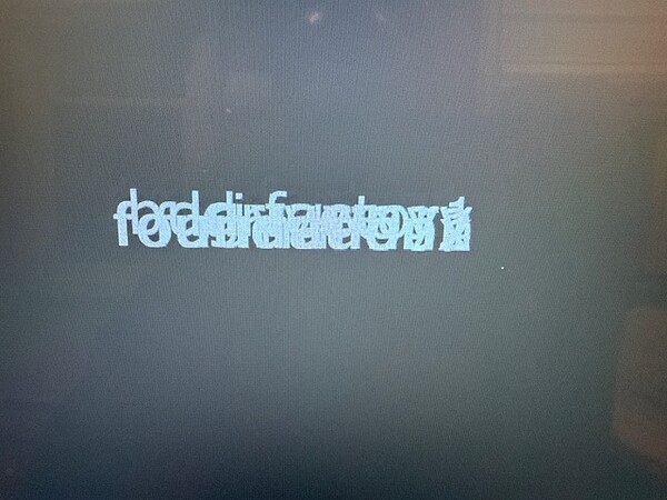

I reached purchased an emlid rsv3. I was able to record some points and am experimenting sending them in a dxf file to autocad lt. when the points show up in autocad they are very very small with large text all jumbled together on top of the text for all the points. Anyway to transfer it in as shown on my emlid flow app?

The dxf data transfers to ACAD LT and I can change the point size with PDMODE but cannot change the text sizes for point ID, elevation, etc.?
