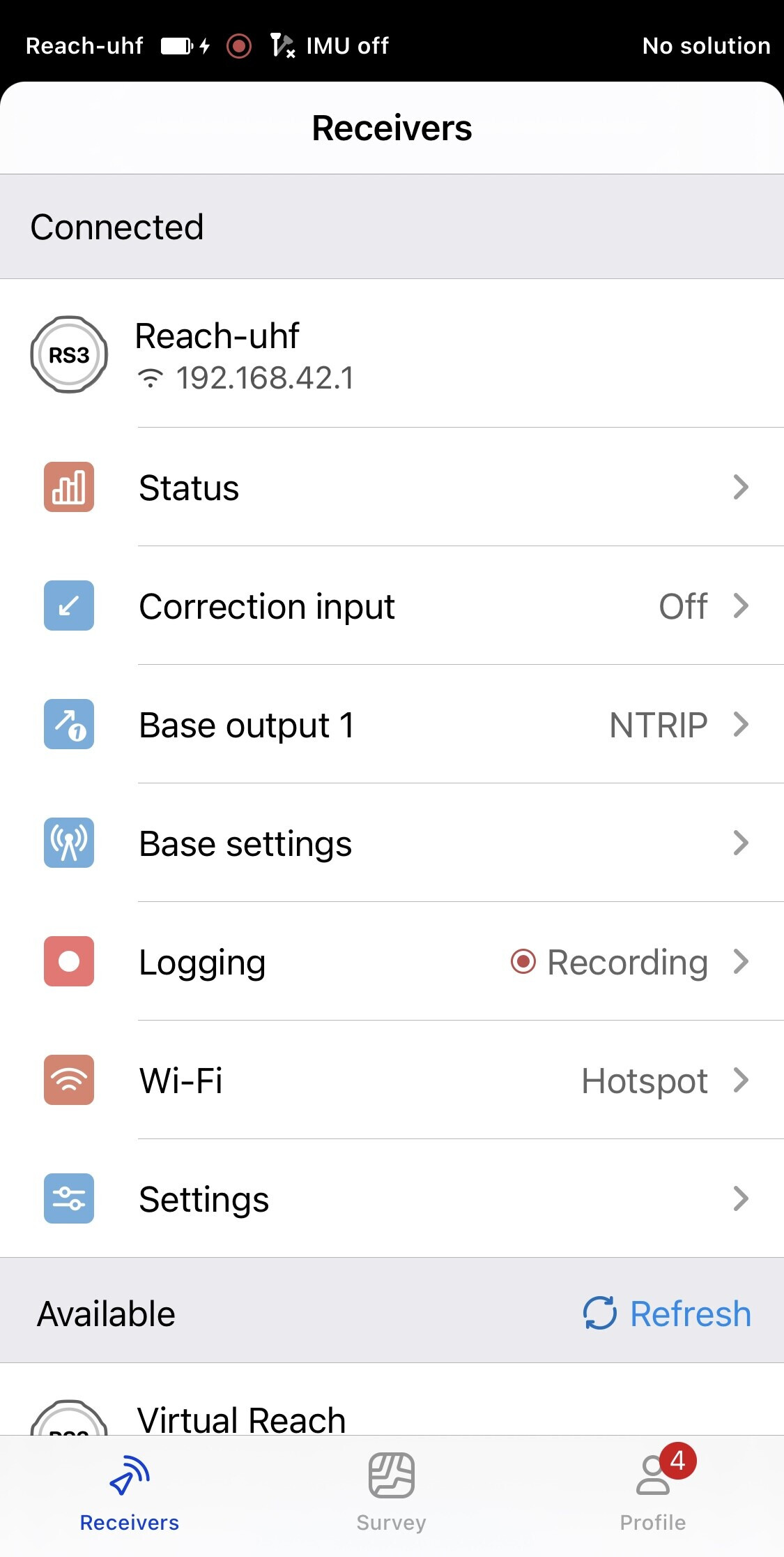

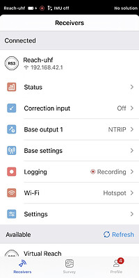

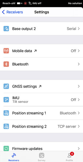

Starting from version 33 Beta, you can now publish corrections simultaneously in two types of outputs. I’ve attached a screenshot for an example Base Output 1 as NTRIP and Base Output 2 with Serial:
You can find Base Output 2 in the Settings section. I hope this makes your workflow even smoother!
