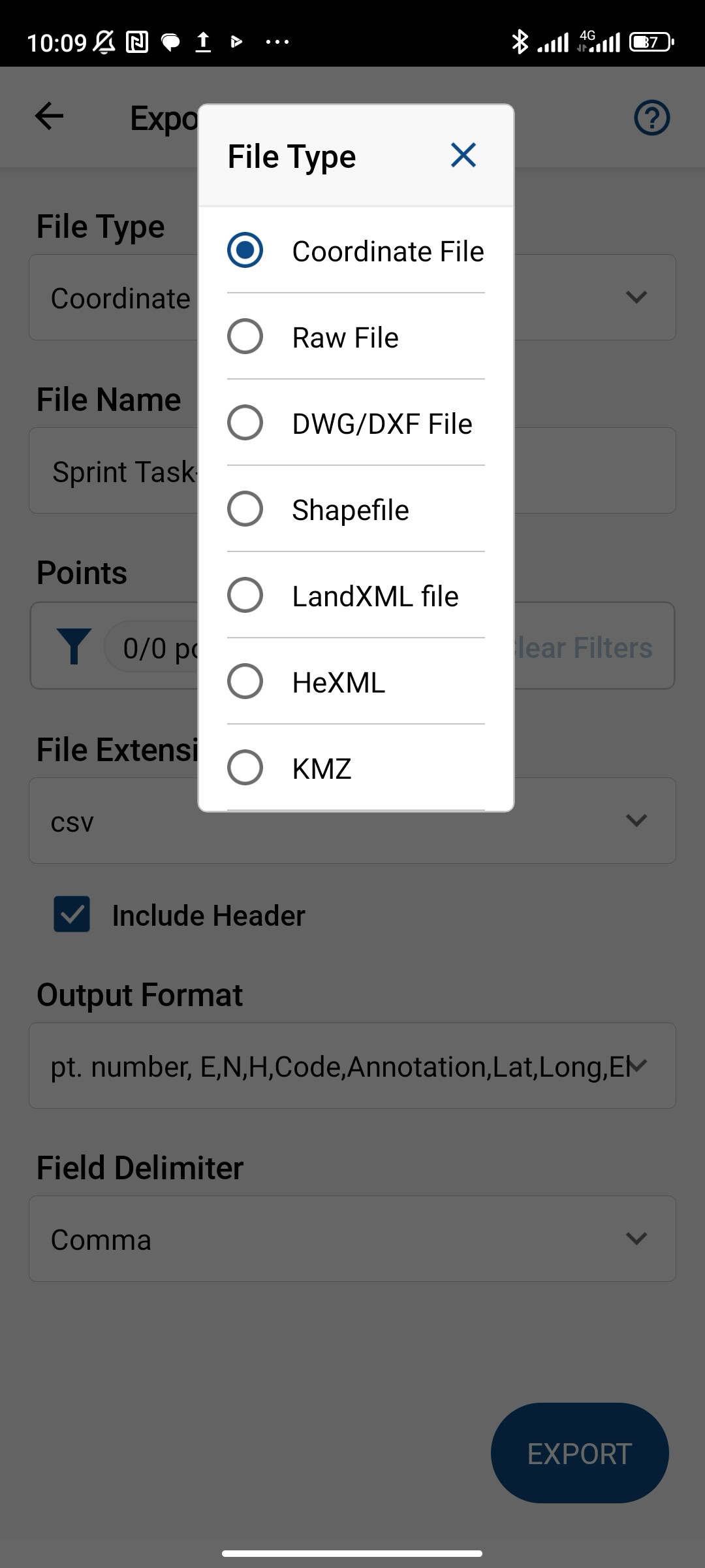

@aricee23,
I checked, and FG Android supports the export of raw files, which you can use in STAR*NET.

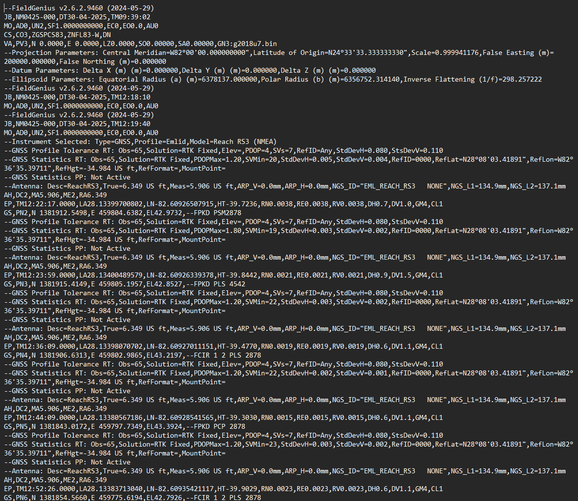

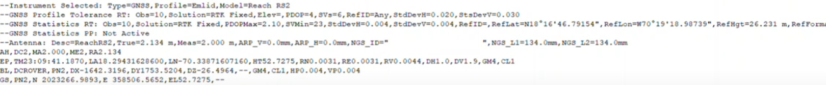

yes but the raw file exported from fg is missing baseline data therefore useless in starnet unless i’m missing something. should have BL tag but its missing.
This is what it used to look like and what starnet expects I pulled this from a how-to for starnet Notice the BL tag
Thanks, I’ve tried that but the bl data is missing from the raw file on that version, same as android version.
