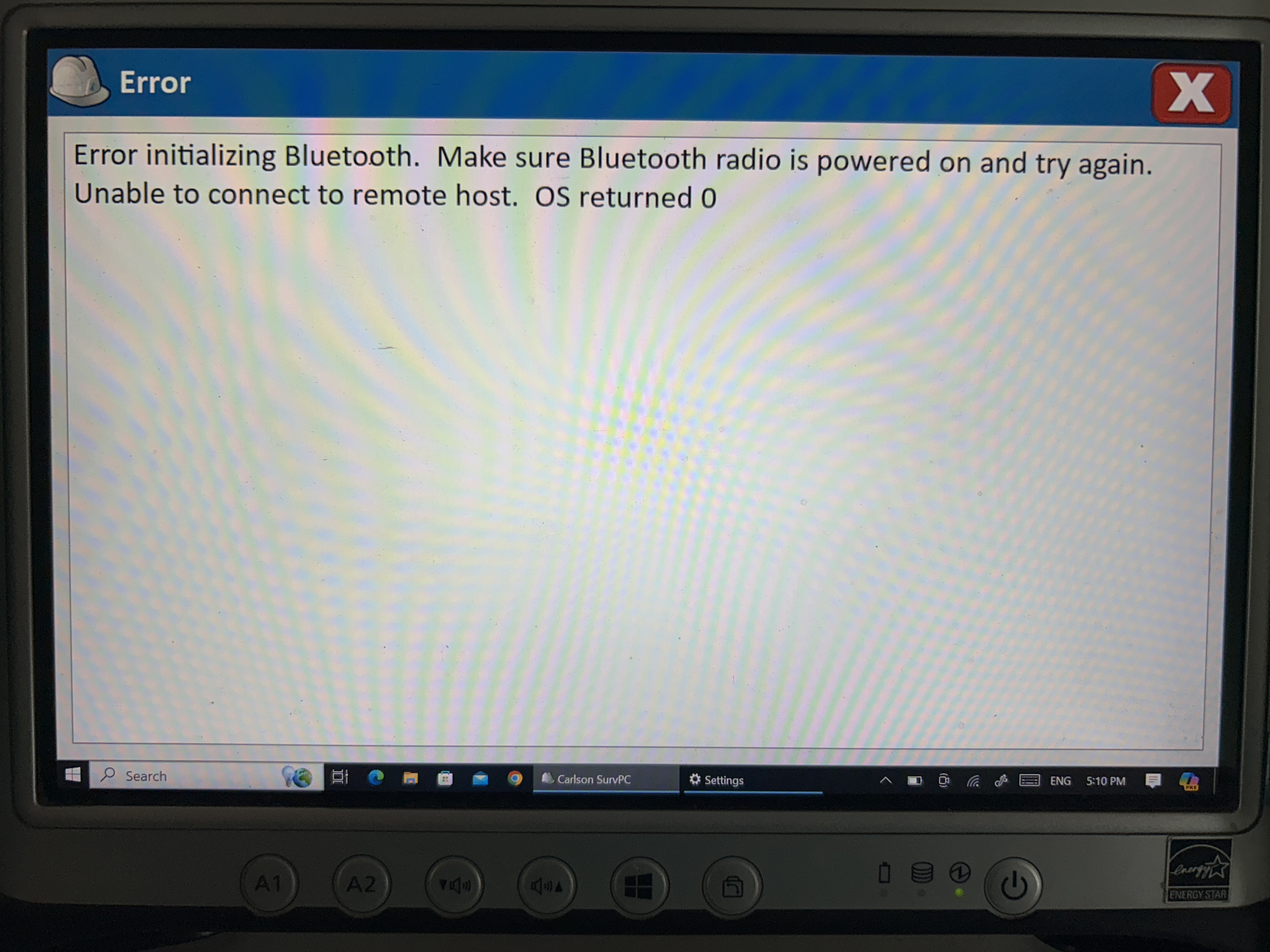

Hey guys. Had been using RS3 with Carlson SurvPC on a Panasonic Toughpad Windows 10, no issues. Hadn’t used the setup for maybe 3-4 months, got setup today and SurvPC couldn’t make the BT connection to the RS3. SurvPC could see it in the devices list (deleted the RS3 and forced a search for it again) however when attempting to connect, it would time out.

Thankyou for your response. In My Windows 10 tablet Bluetooth settings, it is only able to ‘pair’ with the RS3, only very occasionally and briefly managing to reach ‘connected’ status. I have managed to connect me tablet to other Bluetooth devices without issue.

Thanks for your response. Yes I have tried unpairing and repairing approx 100 times haha. No windows update has taken place in the last 12 months.

Though alot of trial and error, i have discovered that it is necessary to have bluetooth on my phone turned off completey when using the RS3 with Toughpad and SurvPC. Even then, for some reason, it won’t connect and i need to reboot bot the receiver and tough pad, and generally this solves the issue
