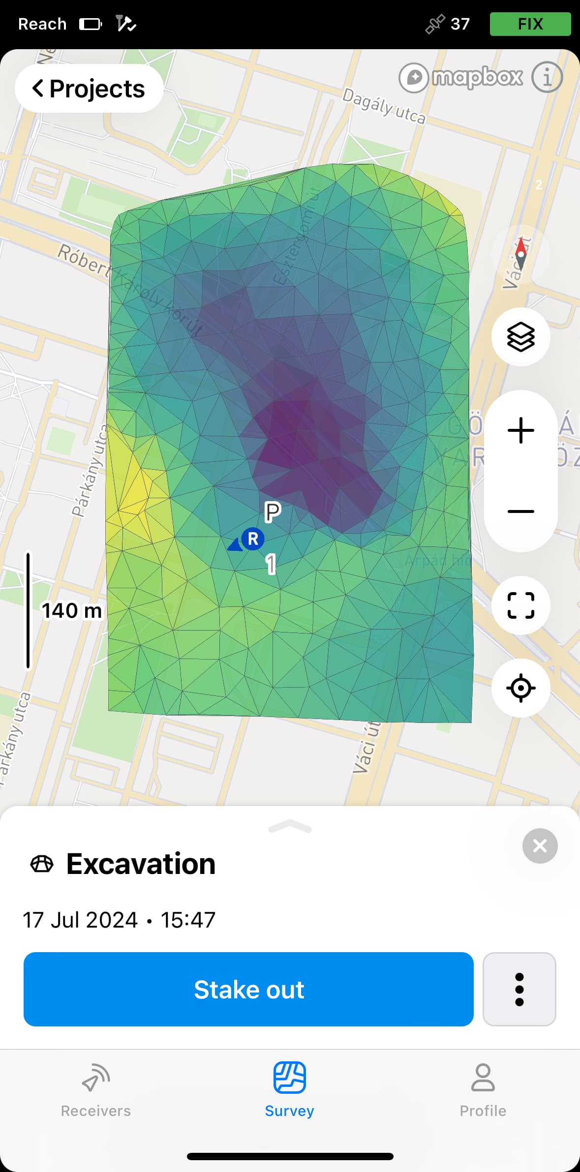

Hi Josh,
I’m excited to share some great news with you!
With the release of version 11 of Emlid Flow, you can now import and stake out LandXML surfaces. You can find all the details in our guide on working with surfaces.
This feature is included in the Survey plan. If you’d like to try it out, you can get a free 30-day trial of the Survey plan here. I’d love to hear your feedback on how it works for you!
