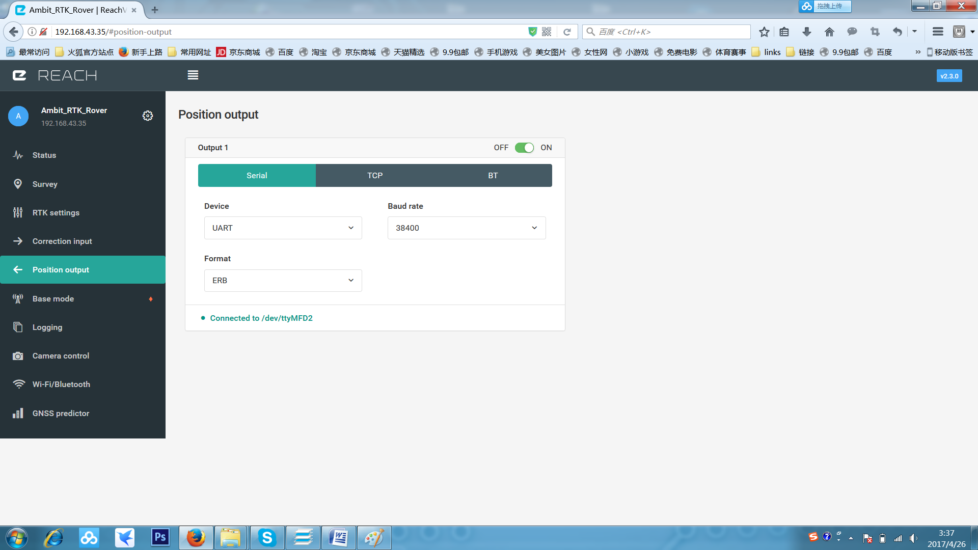

below are some pics to show the setting of reach . for your renference . oh our reach connect to pixhawk through UART 4/5

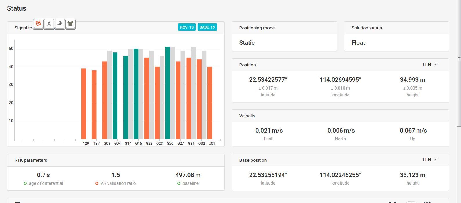

is it because the single ,or something else ?
There are couple of things i see:
1.Low amount of satellites with SNR above 45, and many of the sats visible to base is not visible to rover.
2.Do not use AR glonass with base other then Reach. For your case, turn it off
3.Disable additional correction, i can not see why you should use this as it is from the same service
4.Disable base mode
