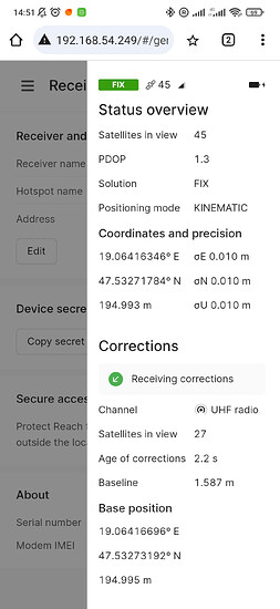

  • Signal strength indicators in Reach Panel: for Reach RS2/RS2+ when receiving corrections over LoRa and for Reach RS3 when receiving corrections over LoRa and UHF.
