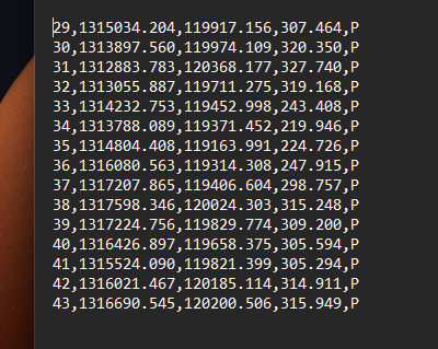

When I export a CSV from Emlid Flow 360 on PC all the points get renumbered. This has been an ongoing issue, is there ever going to be a fix?
See screen shot
See screen shot
Hi @Sam_DeLong,
To confirm, you are using the PENZD export, right? If so, this is the expected behavior. With the PENZD export, all the points are named as numbers.
You can use the custom export instead to retain the names. However, this is only available under the Survey Plan.
That is a nice work around, but truthfully I think EMLID should not have Point “Numbers” change. I just can’t see the reason someone would do that, there are never letters in the point number box so I don’t understand why?
Hi @Sam_DeLong,
We designed it this way as AutoCAD only accepts point names as numbers when importing points from the file.
