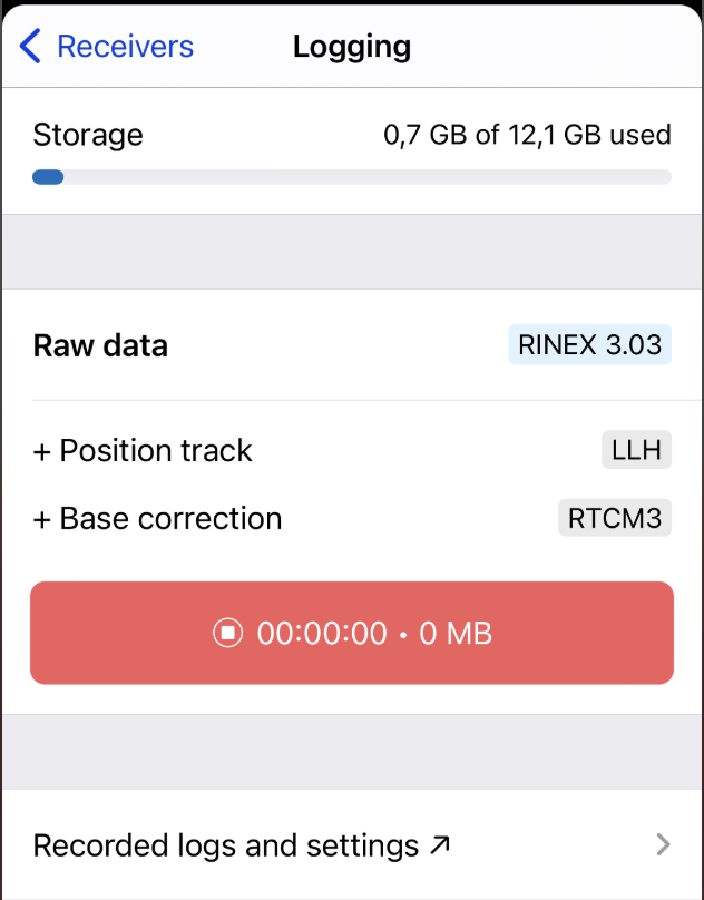

32 and 33 beta 1 worked fine. After updating to 33 beta 2 the saved log only have LLH. I tried again now 2 times (I remember there as a first log issue) but both files have LLH only.

I checked the settings and it was supposed to log observations and ubx besides LLH.
I reverted to 32 stable for the moment, I have to log raw data soon and better be safe..

Thanks for bringing this up! We’ve looked into this and were able to reproduce the same issue, where only the LLH file gets saved. This happens specifically when using the Apply and Start button in 33 Beta 2.
I am truly sorry about this issue. Unfortunately, the logs from that session can’t be recovered. We’re already working on it to ensure this doesn’t carry over into the stable version.
For now, there’s a way to avoid this: if you apply the changes first and then restart logging, it should work fine. You can also start the log directly from this tab to bypass the issue.
