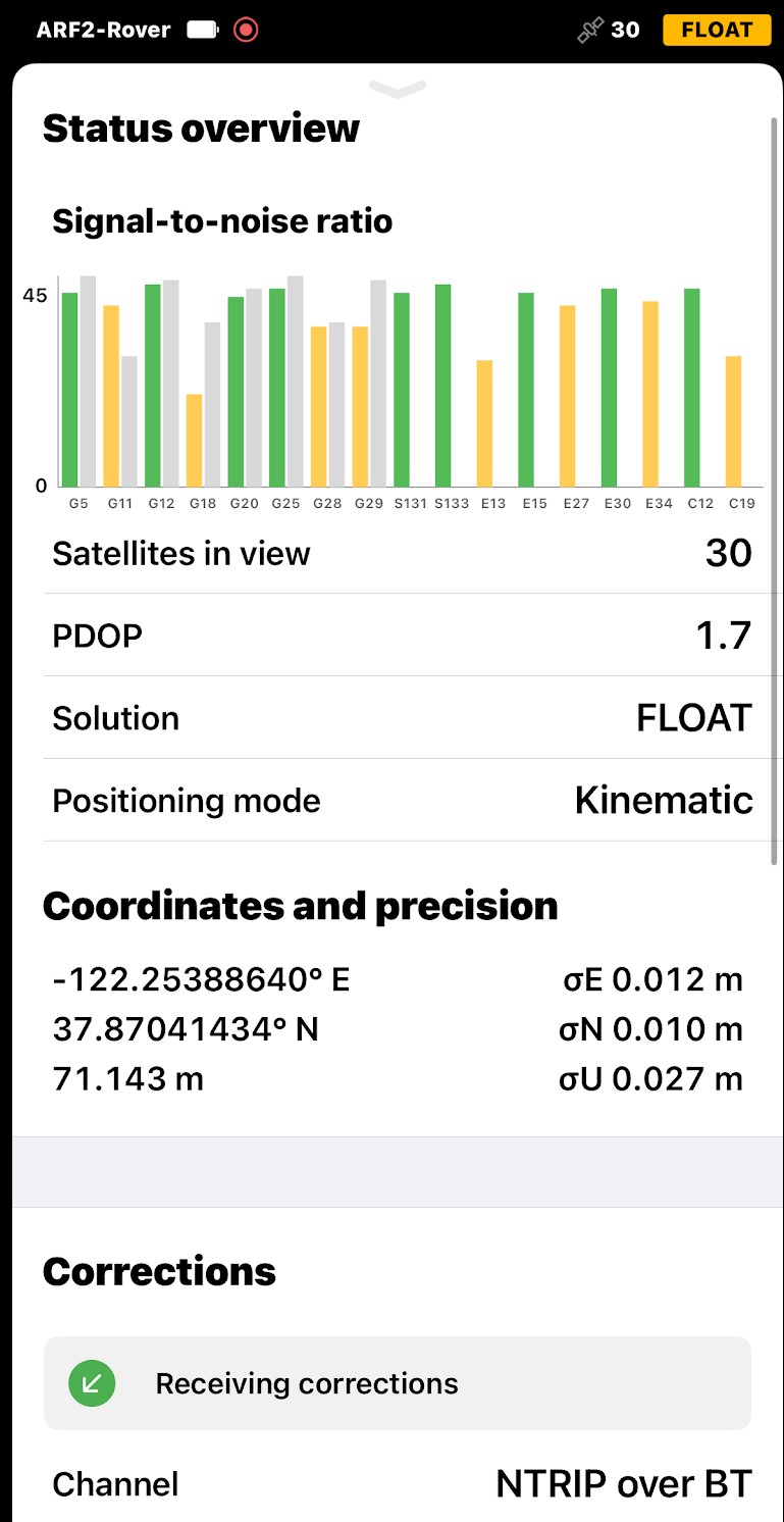

I’ve recently started using NTRIP over Bluetooth. I was finally able to get it to work once I completely deactivated Wifi on the RS2 and changed the Correction Input mode.
I’m getting quite good quality Float (under 2cm horizontal error and 3cm vert error), but I waited for over 10 min after achieving those Float values and it never got FIX.
I tried with my controller phone on my university campus Wifi and on cellular 5g. Is there some latency issue with bluetooth that prevents Fix?

From the screenshot, the unit is receiving corrections, so we can eliminate the idea that the setup and configuration are the issue. In such cases, the cause is likely due to the unit’s placement. Can you ensure the unit is ideally placed, following this guide? This can better the solution and give reliable results.
Also, to confirm, were you getting Fix when working with NTRIP over Wi-Fi?
Just from the screenshot, I’m seeing only GPS constellation receives corrections. If the number of satellites visible is too low for uninterrupted corrected calculation, it might never give you a FIX.

We were working in a pretty open space and (to clarify) when the RS2 is on the wifi network directly it receives NTRIP corrections and achieves FIX quickly. When it’s NTRIP over Bluetooth it only makes it to Float so I’m wondering about some latency in the Bluetooth transmission between the tablet and the RS2 unit.
