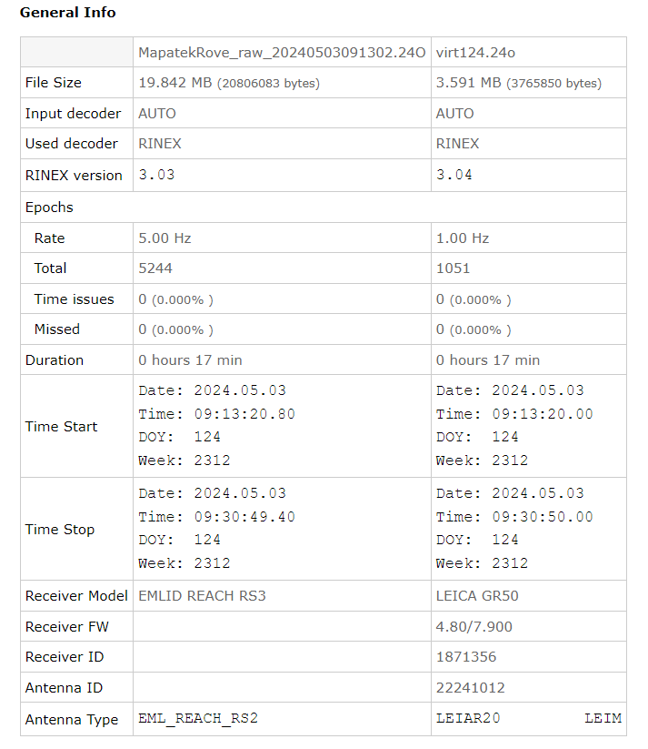

I’ve checked your logs, and observation files from the base and the rover don’t overlap in time:
  • Base file time: 06:22:54—09:01:04 GPST
  • Rover file time: 09:13:21—09:30:49 GPST
That’s why corrections are not applied, and you get a SINGLE solution only. Do you have logs from the base recorded a bit later, at the same time as on the rover?

Hey, have a try with this base.
It is a virtual base I generated using the surrounding CORS from the ERGNSS network. Should do the trick. The coordinates of the RINEX header are the correct one to use in ETRS89.

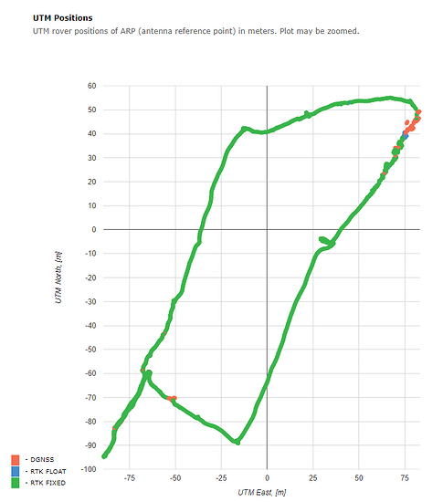

I’ve attached the result and it looks good. The resulting single and float values are to be expected as there was heavy vegetation in that area.
Florian, do you have any references on how to create the VRS station? This is one of the items on my ‘list of things to do’. :slight_smile:
Here’s the result:
Thanks once again!

Yay! Just a side note: You can also try to play a bit with the processing settings in Emlid Studio. For example, choose the Combined filter type. It won’t change the data quality, of course, but it’ll make the algorithm go Forward and Backward through the data. It can help get a higher percentage of FIX in some cases.
If you want to learn more about it, feel free to take a look at the Assessing raw data and Tuning post-processing solution guides from our docs.
