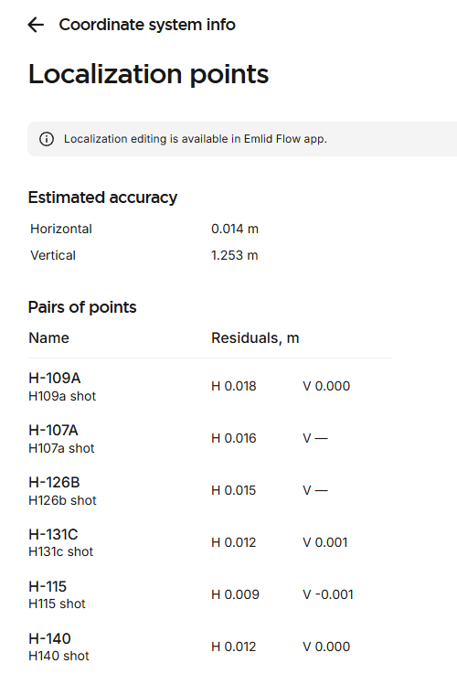

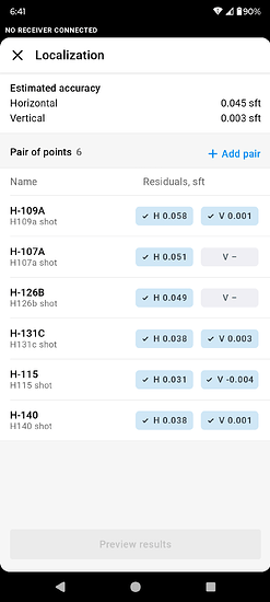

I went out and shot some of the control points. I was not able to use a local base station, and needed to use a commercial subscription NTRIP service (28km away). I’ll be able to set up a local base station next week once the equipment arrives.
I’m a bit confused by the initial results. For 6 points, the average difference in the shots vs. the control points was .045sft. which I thought was pretty good.
The verticals, however are all over the place. I expected the shots to be about 3.5 feet below the control points. In reality, some were above, some below 1-2.7 feet in each direction.

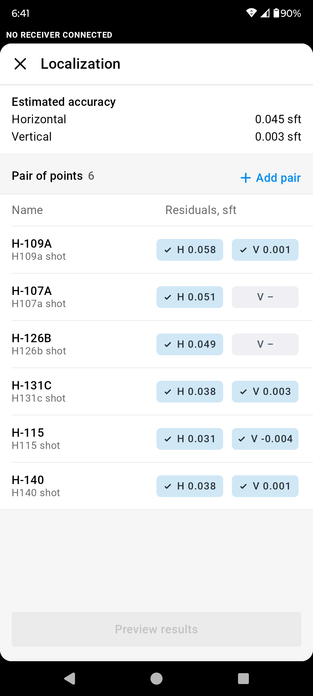

I played around with the localization, and noticed that the results are different when viewed in flow vs flow360. The units are different (meters vs sft). The conversion is correct for horizontal, but for vertical seems way off (by feet). What am I missing here?
Data and screenshots attached…

@Mark-R,
Thanks for sharing the results of your site calibration and the dataset. I was able to reproduce it on my end as well.
I’ve reported this to our developers. I’ll let you know as soon as there’s any news on this!
You could use NGS NCAT (NGS Coordinate Conversion and Transformation Tool (NCAT)) or NOAA’s VDATUM (https://vdatum.noaa.gov/) to transform the heights from NGVD29. If you have the ability to make recommendations to the client, I’d suggest updating their project from NGVD29 as it’s quite limiting to find good control in that datum. It’s obsolete now and will become even moreso when NAPGD is released. I’ve been in this boat in the past, so the transformations might be the best way to go for now. Good luck!
