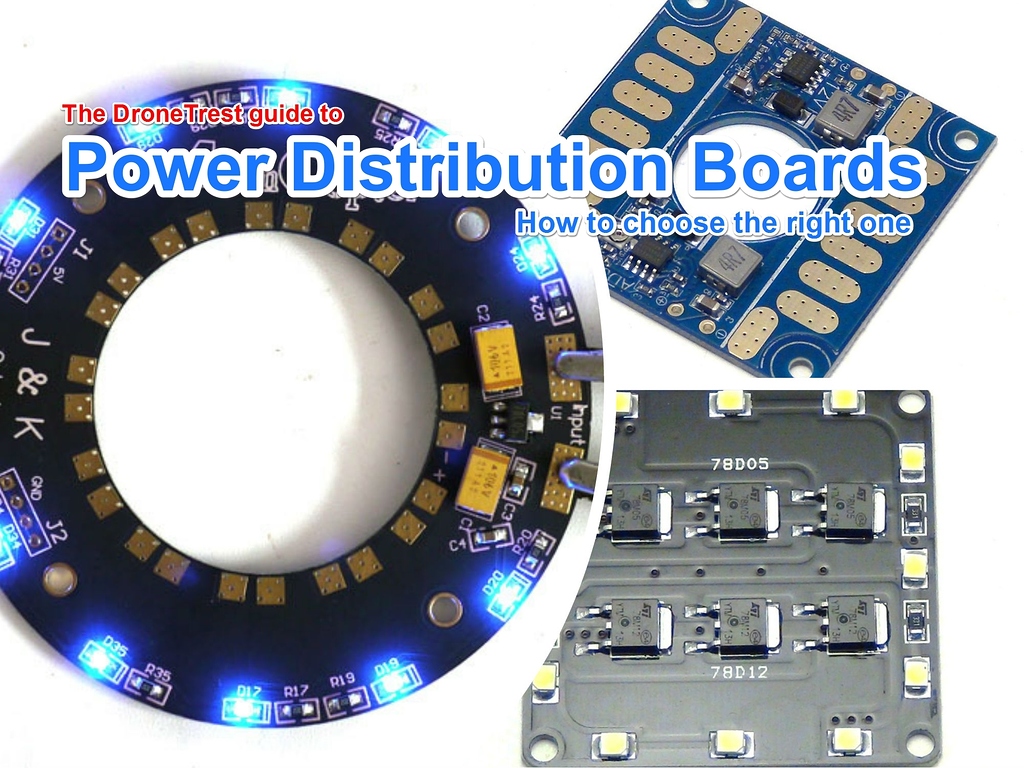

The ESC’s get their power from the PDB and are OPTO escs
Can you please share model name of PDB or if it is unknown, picture of its back side.
I’m quite sure it needs a Power Module.
Take a look at this article, its 1st picture:
Btw, I already tried connecting 4-in-1 ESC without power module, directly to battery.
It did not work at all.
May be that was just my case. But for me it was failing without Power Module.
What type of esc did you have
