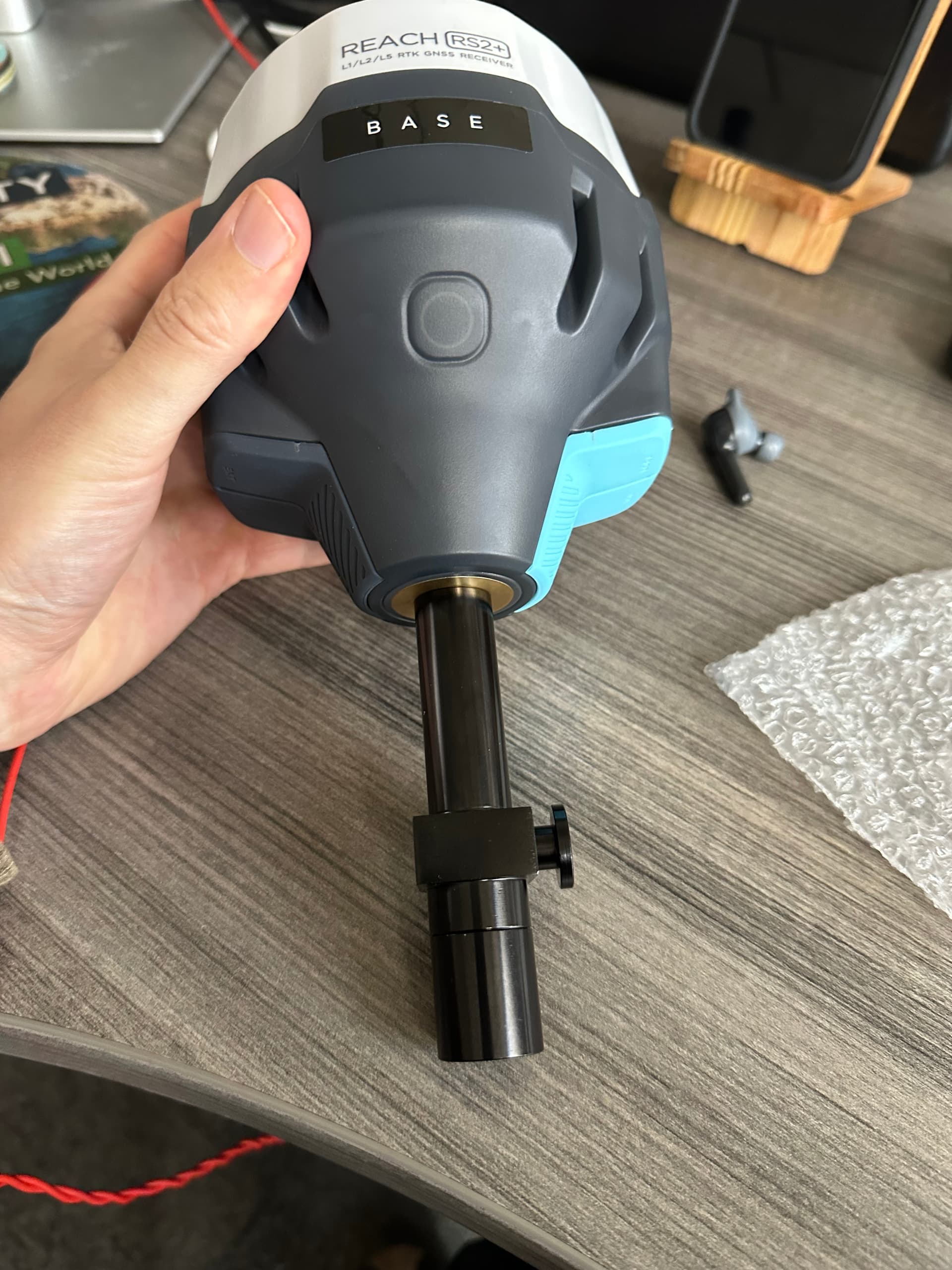

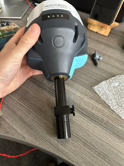

So per the images i have a DJI RTK base station tripod that my org has for our legacy DJI TRK Base Station, we bought a Reach 2 Plus as we are branching out to non DJI drones and the DJI gear does not work with non DJI equipment.

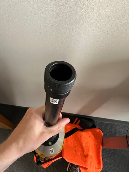

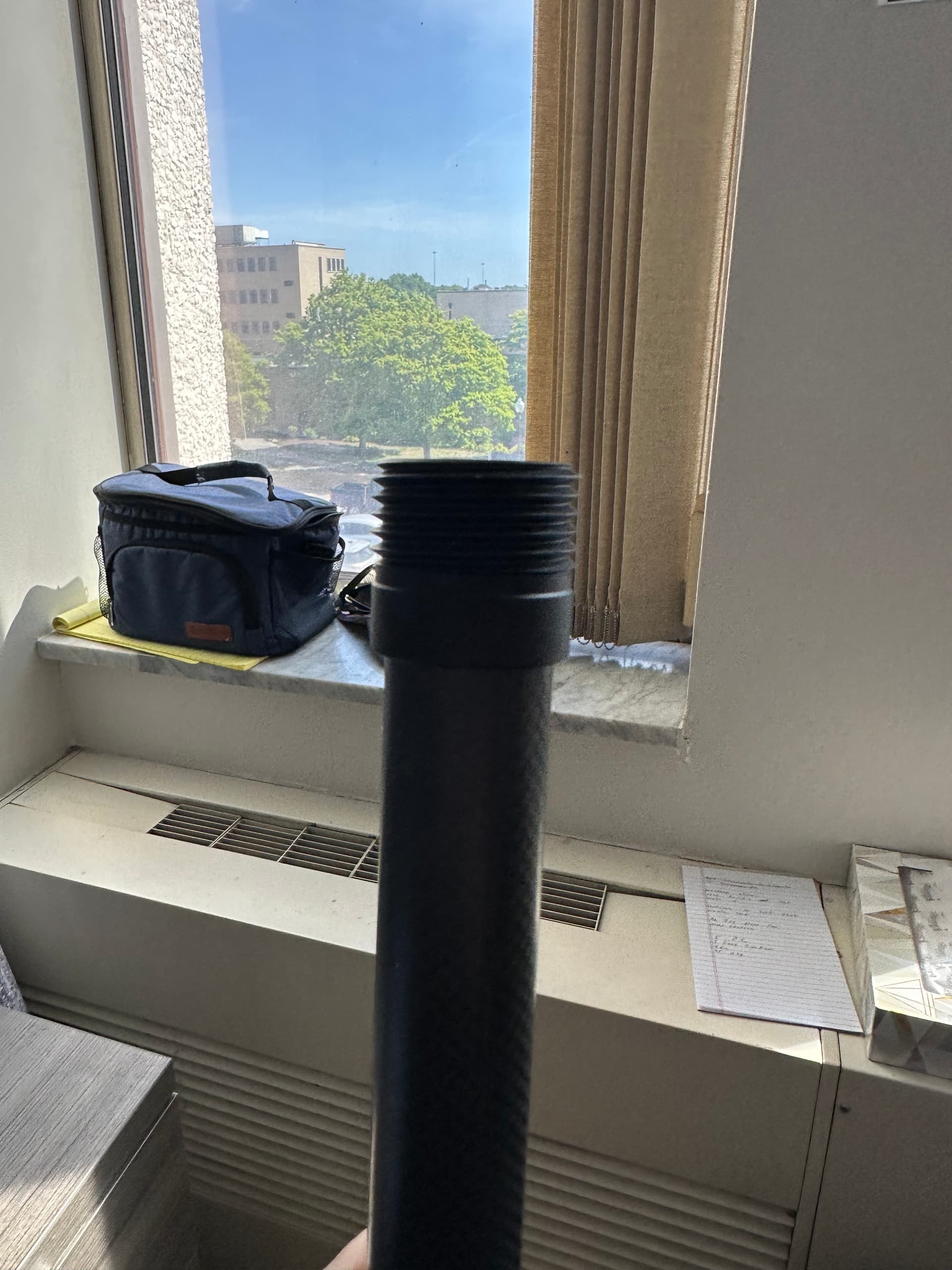

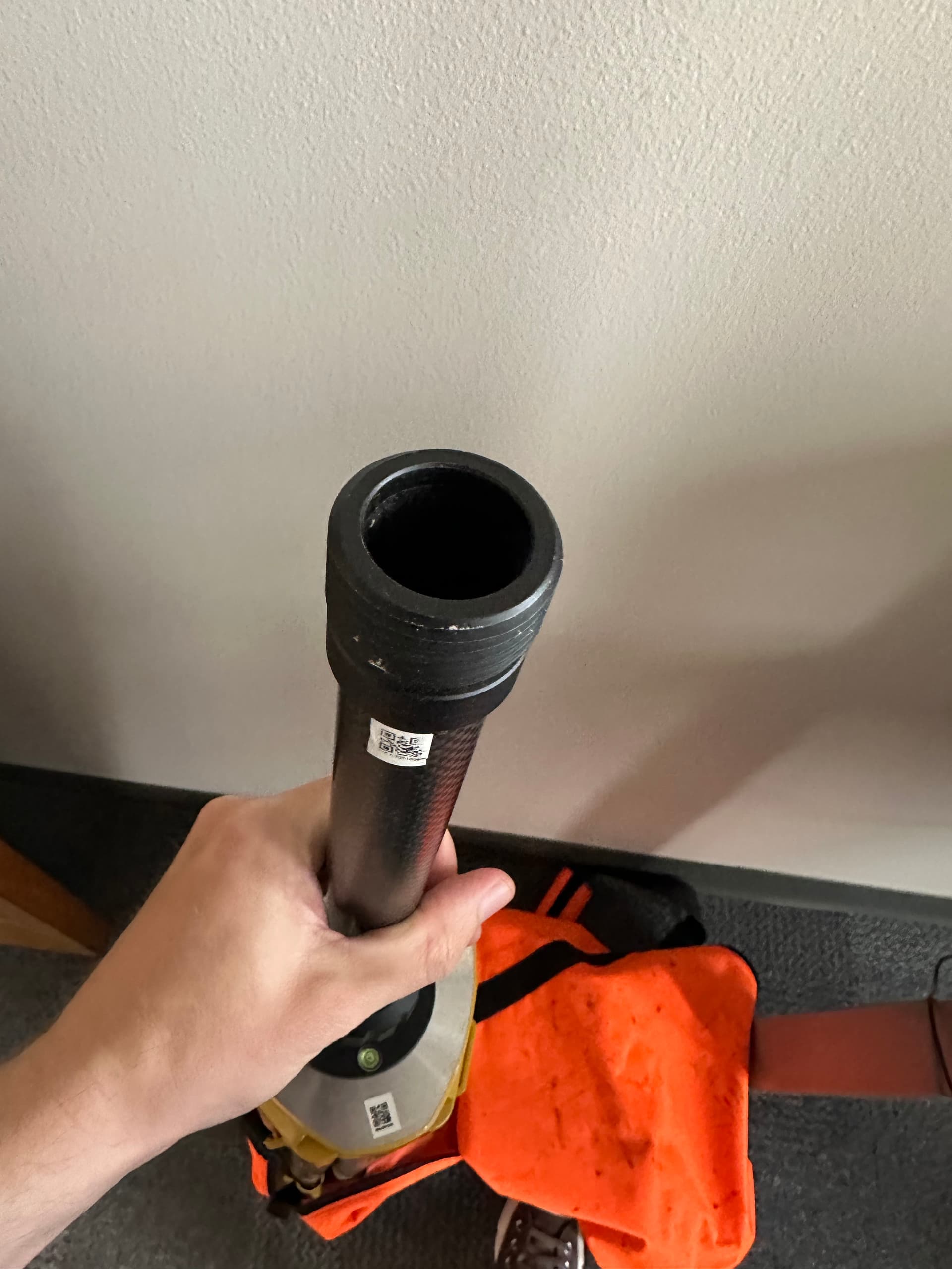

I am having issues with trying to reuse the existing tripod with the new Reach 2 plus. I have an adapter that should give me the clearance for the antenna, but trying to find an adapter that will work on the survey pole is giving me fits. The threads are on the outside so I think it is a female adapter? The picture of the DJI base station is for reference as you just screw it on.

What’s the thread size on the pole ? I can’t tell by the image what size it is. Standard for survey equipment is 5/8" x 11. If this is the size, you would need a 5/8"x 11 male to female adapter to mount to the adapter on rs to the pole. I haven’t seen that kind of rod before. Will the adapter screw onto the pole ?

Reach RS2+ uses a 5/8”-11 thread. If your tripod has a 1/4”-20 thread, you can use a 1/4”-20 female to 5/8”-11 male adapter.

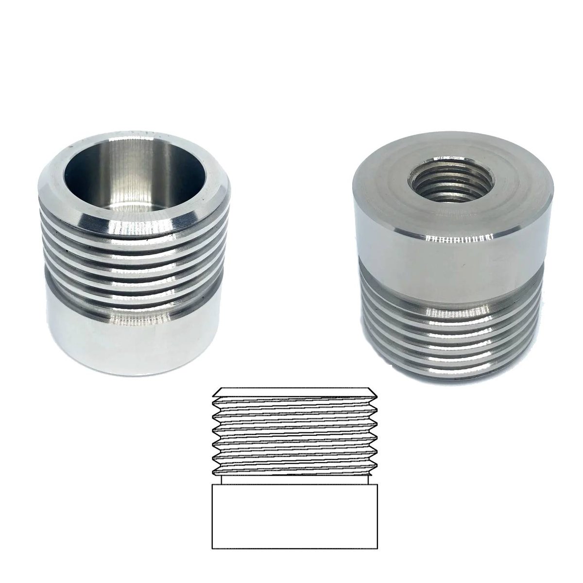

If you all see the picture above the D-RTK 2 has a “proprietary” external thread and the mounting hole on the bottom of their receiver is about 1" diameter. Is that correct @longze? The adapter below is the opposite of what needs to happen to use that pole with a standard 5/8" so you just need to find out what the DJI-side thread is. Seems to me that is going to be very hard to do without a custom machined or 3D printed part.
I think your right, I will probably have to get a new tripod, slightly annoying that DJI does the proprietary mount for the survey pole.

If you are not willing to “home brew” an adapter, the price on that adapter above would lead me to just purchase another set of legs with tribrach or a GNSS tripod similar to this:
