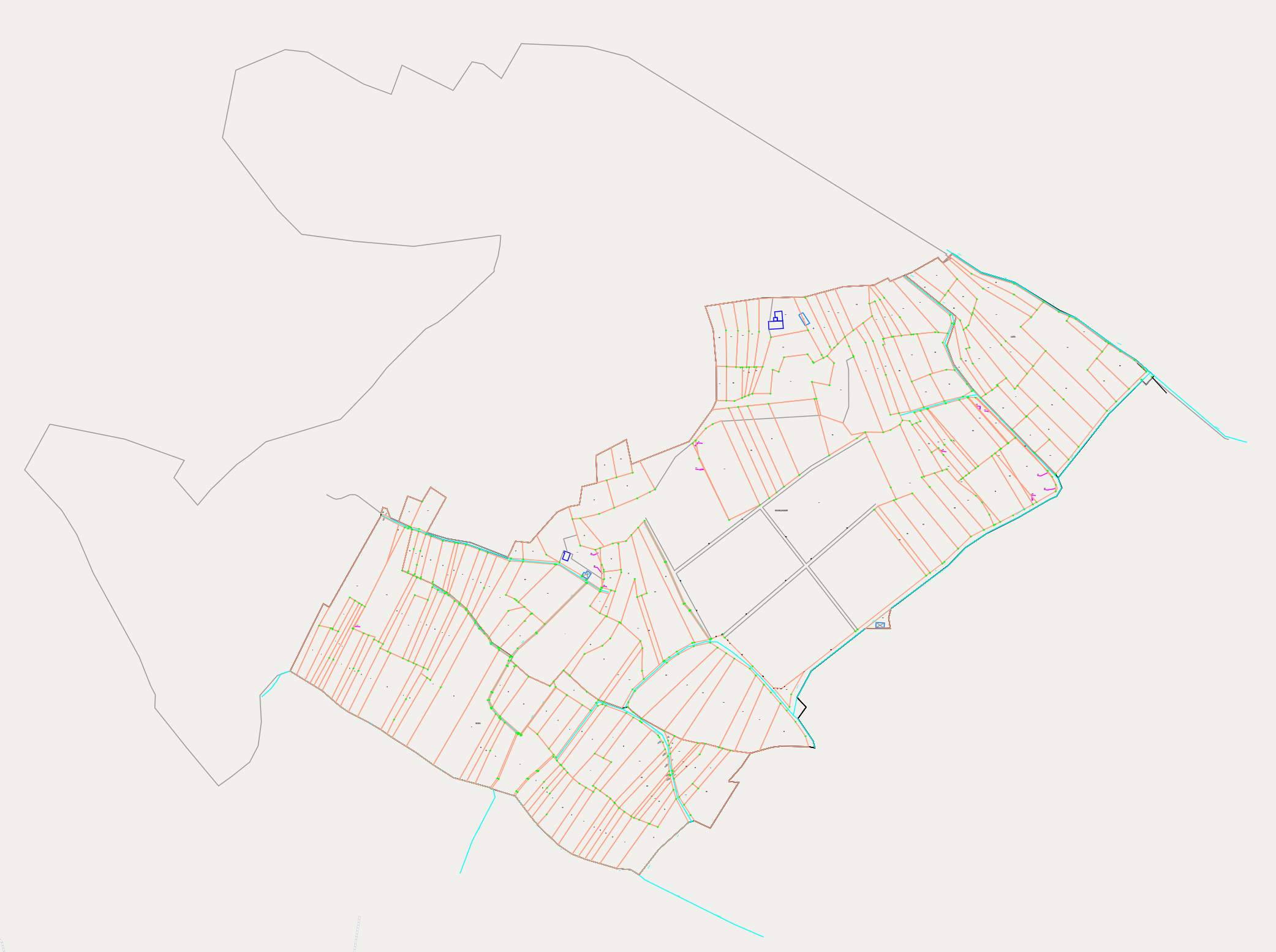

Actually, I have no problem to import it to qgis.
0280002301.zip (61.0 KB)
You may understand better than me, it’s days I try…

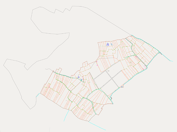

Try this one. Obviously, I don’t know your coordinate system, so I had to guess, but it came in.
0280002301_ADM.zip (136.2 KB)

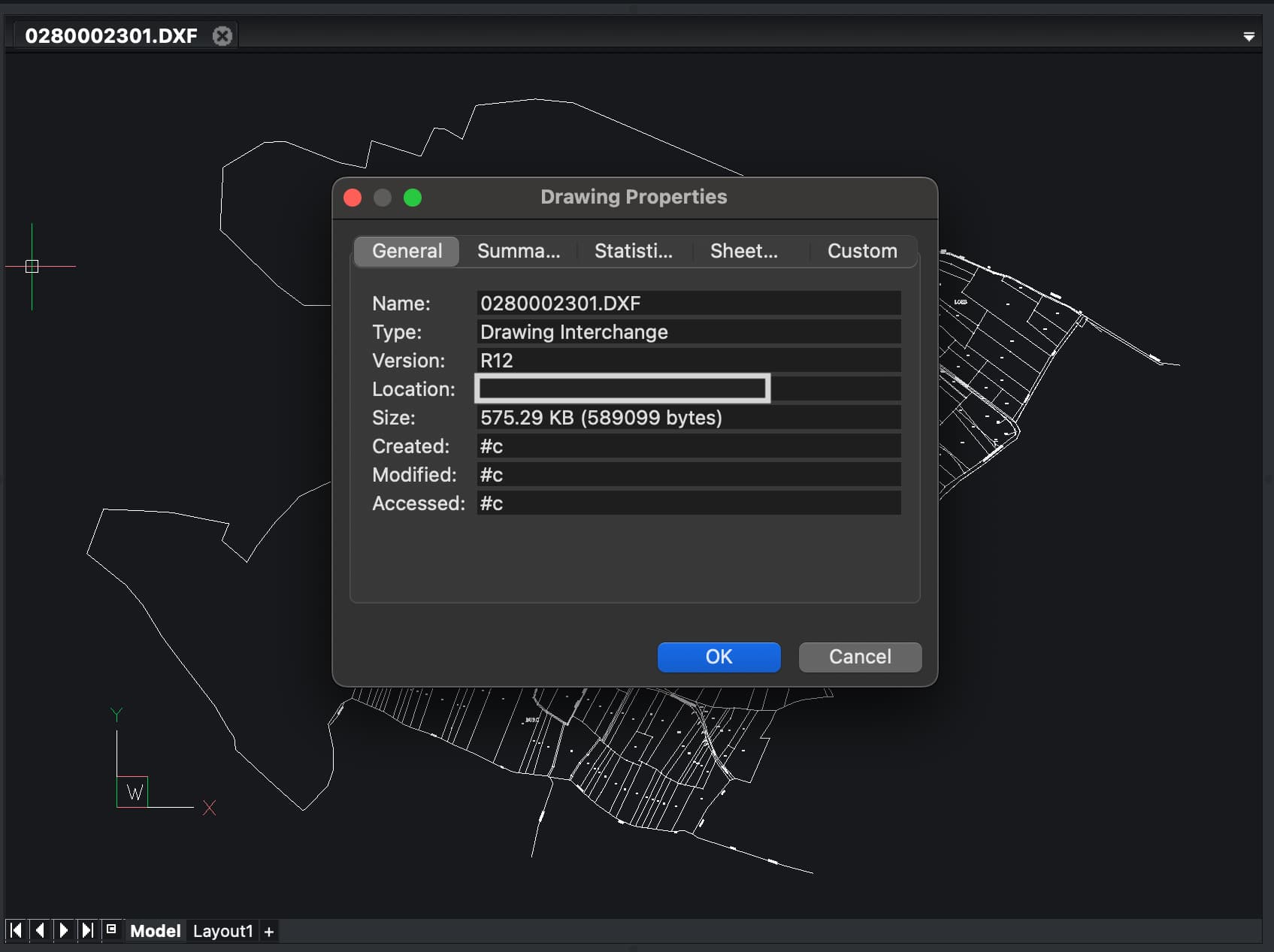

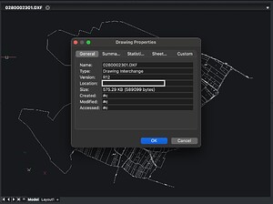

Mathieu,
Your DXF file is in the older R12 format from 1992, which is likely why it wasn’t showing up.
If you resave it in a newer DXF version using any CAD software, it should work fine. I see @michaelL already shared a new version with you. Thanks for that!
