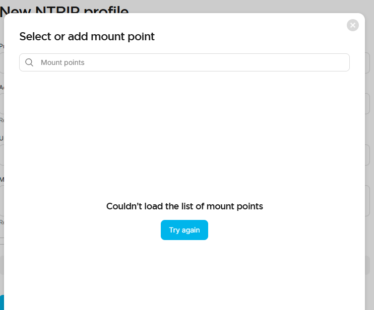

I’ve signed up with the IGS correction system so I can receive NTRIP. I registered and received a confirmation at my email address.
Now I’m trying to choose an IGS Mountpoint in Flow 360.
It’s visible publicly here
http://igs-ip.net:2101
and I see the mount point in the list on a browser window.
In EMLID Flow it refuses to show the mount point list even though they’re listed at the igs-ip.net web site.

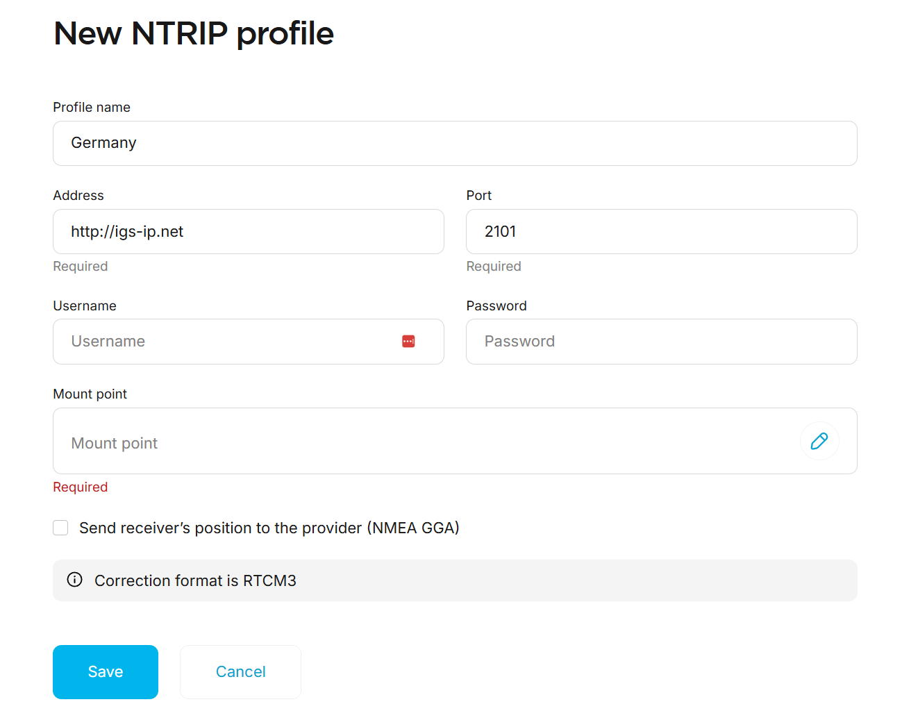

Hi @arf.berkeley.edu,
The mount point list will work if you remove the http:// prefix. This looks like an oversight on our side, thank you for the report.

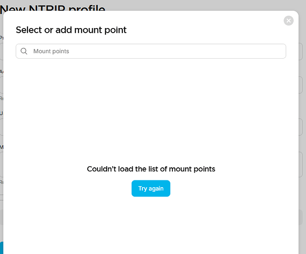

Thanks. It seems a bit better without http:// but still no results
In this case it appears that caster euref-ip.net will work and pulls up mount points as expected. However there are IGS stations outside of EU where that address won’t work so I hope to determine the proper way to reach the igs.org ntrip service.
In this particular case, you need to paste igs-ip.net into the address field and 2101 in the port field. Then it will work.
