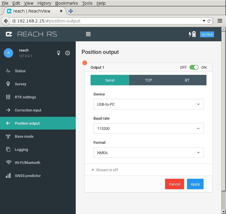

One way to do it is:
Set up for USB-to-PC:
On your Pi, tail the syslog and then plug in Reach:

Hi @bide, thank you for the help. Everything but the part using Reach View is clear to me. The version of Reach View on my Emlid RTK is v0.0.3. I connect my laptop to ethernet and to the Reach to update Reach View in the settings page but it does not update after the 120 second period. Is Reach View v0.0.3 so deprecated that I need to flash Emlid’s firmware first? Is that the only way to change Reach View? I am downloading the latest image now.
There is no upgrade path from ReachView v0.0.3 to v2.10.0, so yes, you are correct to reflash your device.
In doing so, you move from open-source ReachView to closed-source ReachView 2, but IMHO it is worth it for all the UI improvements, plus the GNSS receiver firmware upgrade will enable the Galileo satellite constellation.
