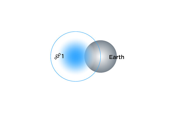

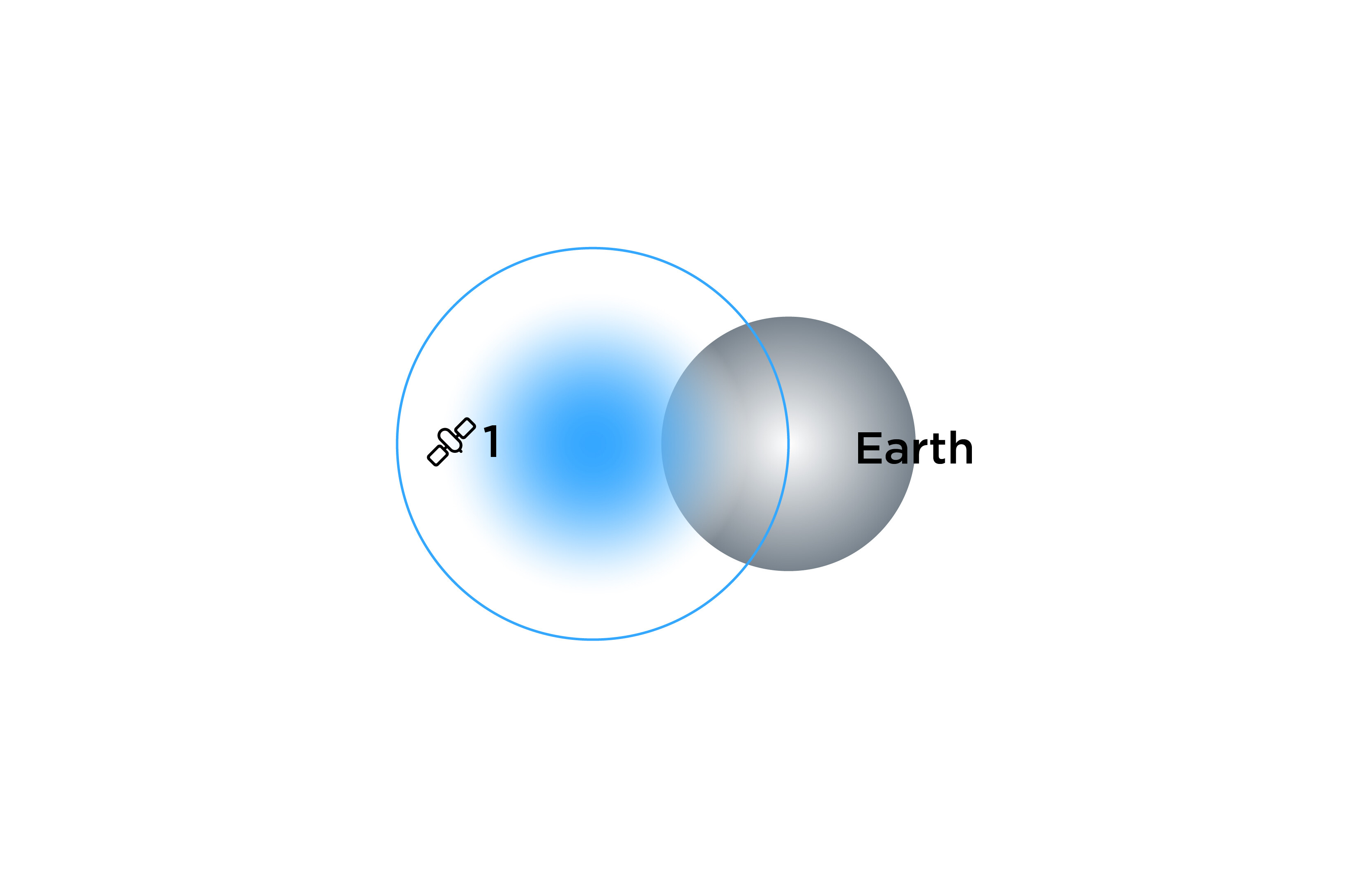

- With the distance to one satellite, you know you’re somewhere on a sphere around it.

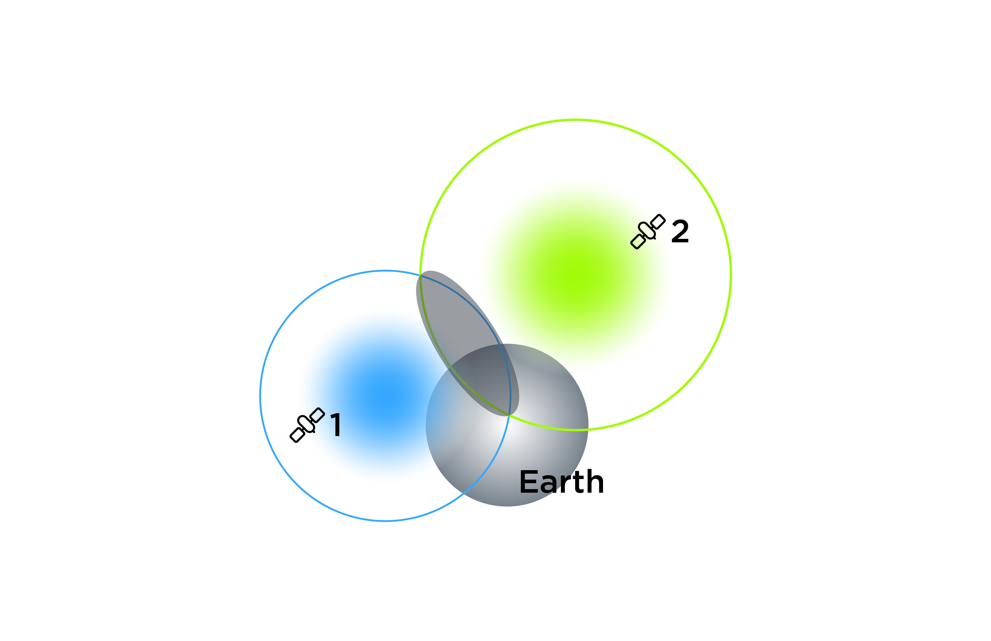

- With two satellites, you’re somewhere on the circle where two spheres intersect.

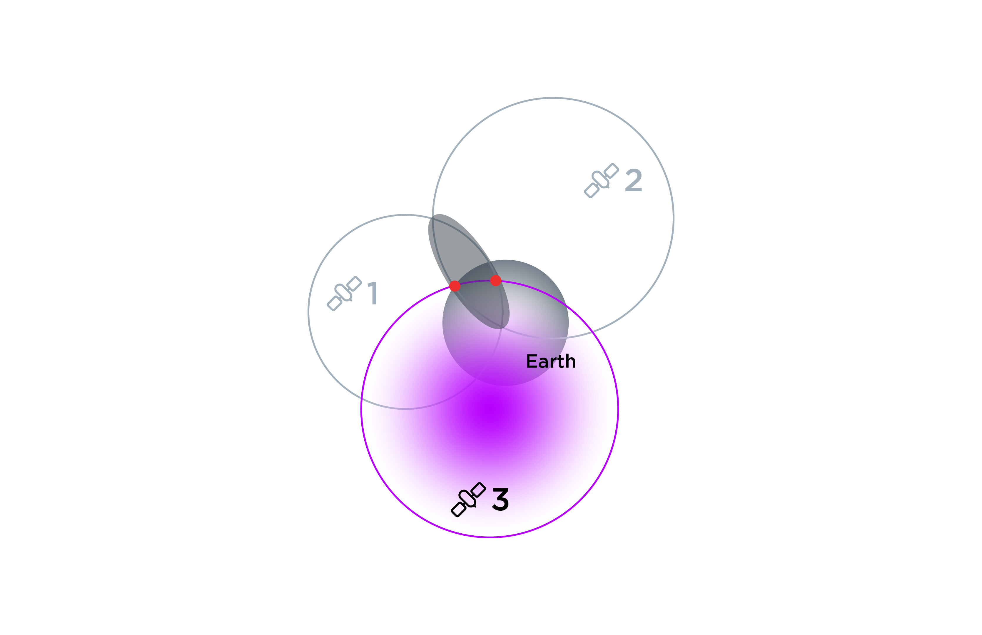

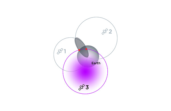

- Three satellites narrow it down to two possible points.

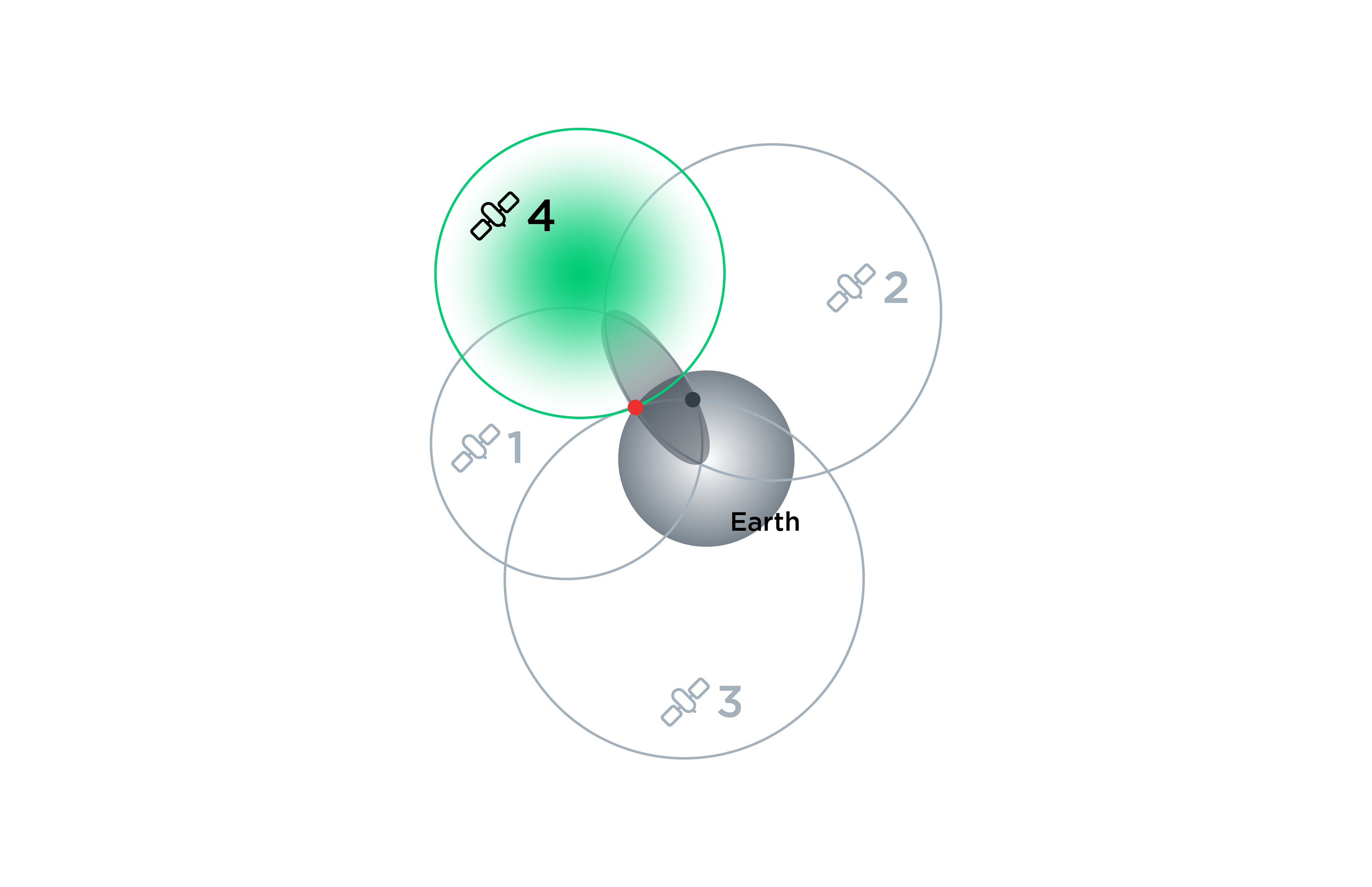

- The fourth satellite helps resolve which point is correct and fixes the receiver’s clock error.
