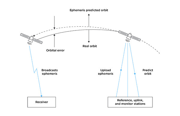

GNSS satellites don’t calculate their position on the fly—they’re placed into precisely planned orbits and continuously tracked by ground control, i.e. reference, uplink, and monitor stations on Earth. Their position is defined within a standardized coordinate system called WGS84. This shared reference frame allows satellites, control stations, and receivers to “speak the same language,” ensuring consistent and accurate global positioning. Let’s break this down a bit.
GNSS satellites rely on onboard systems to stay operational and accurate. Power is supplied by solar panels, while navigation data and system health are managed by internal computers. Precise orbit control is handled by small thrusters and reaction wheels. At the core of each satellite is an atomic clock—typically cesium or rubidium—which provides the ultra-precise timing needed for reliable positioning.
To ensure continued accuracy, the satellites are supported by ground control stations. which monitor satellite trajectories, correct for any orbital drift, and upload updated position data, known as ephemeris. Ephemeris data contains the predicted orbital positions of GNSS satellites over a short period of time—usually a few hours—satellite velocity, clock correction parameters, and health status of the satellite. This information allows a receiver to calculate where each satellite will be in the sky.
