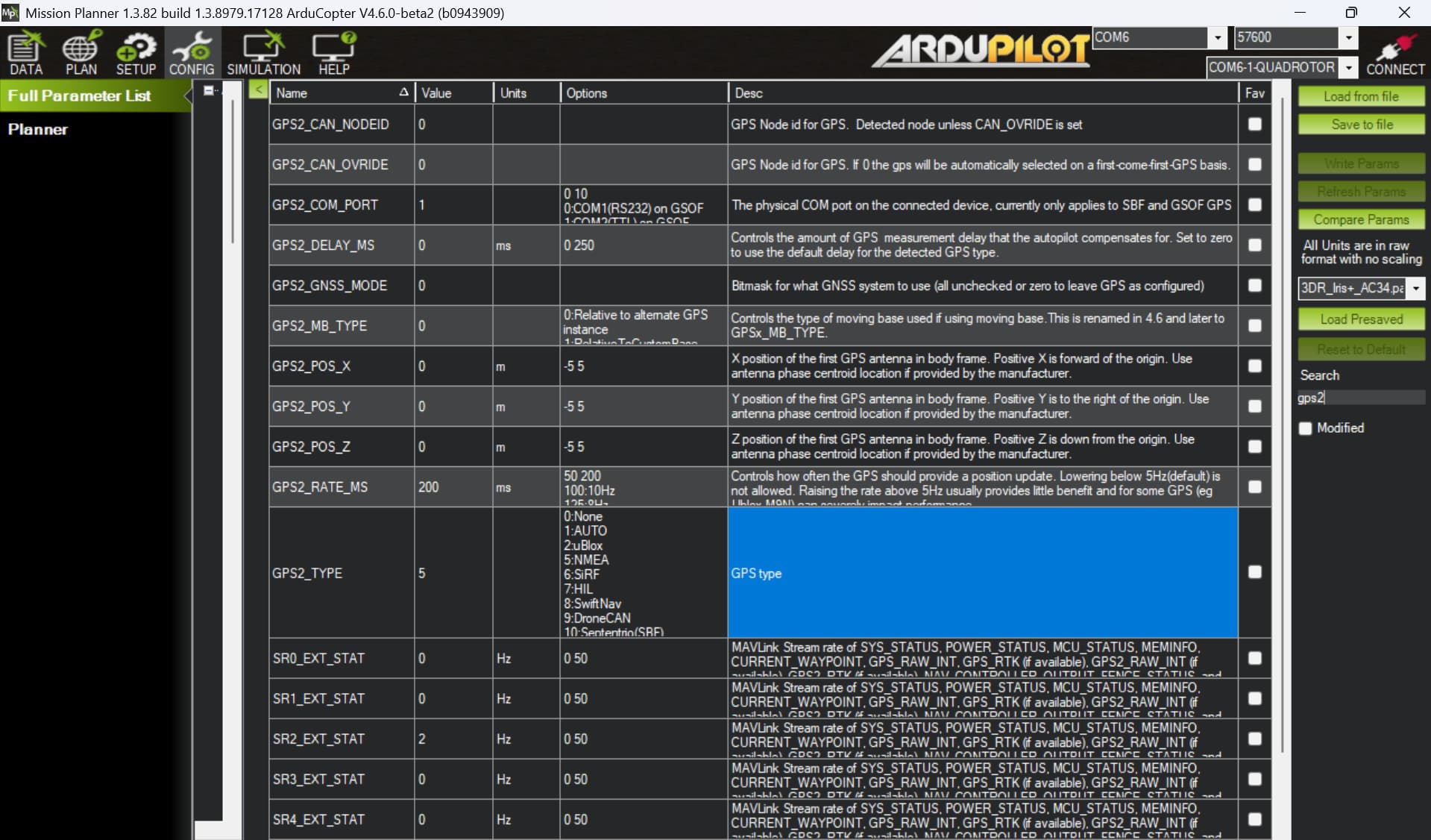

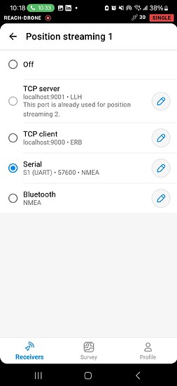

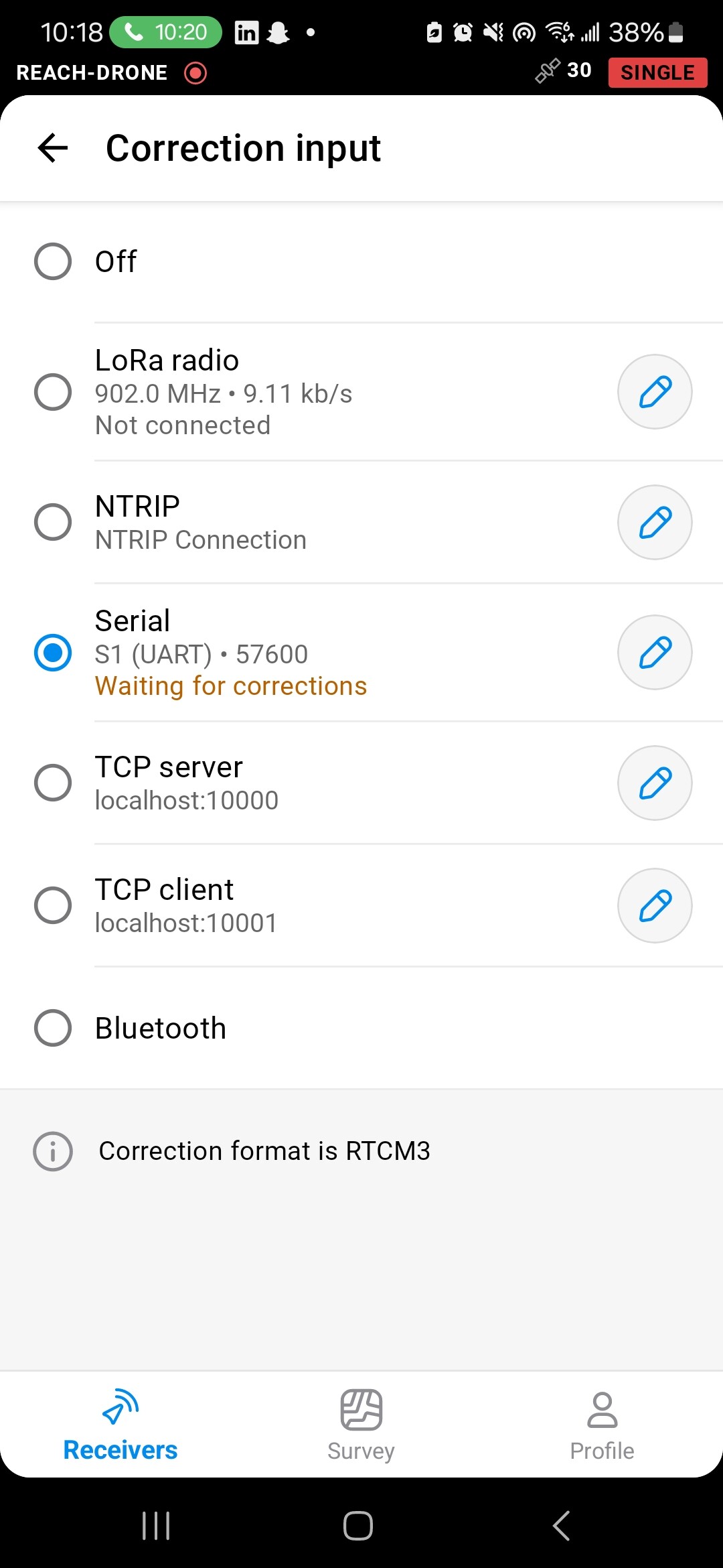

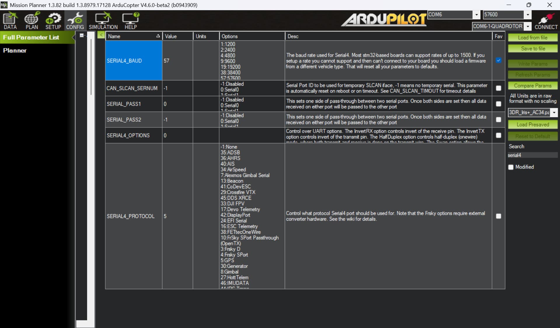

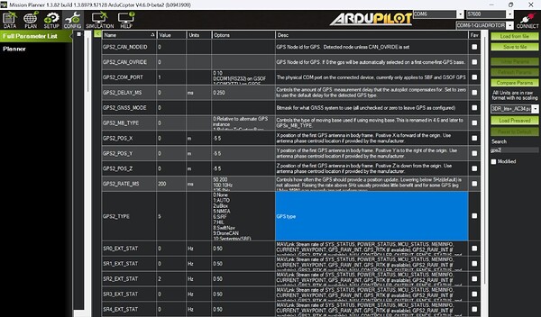

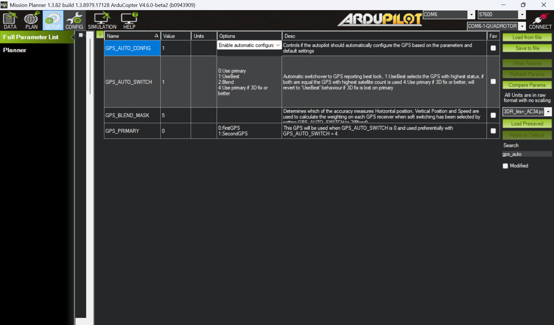

Sorry for the long response, but I just got around to test flying the drone with RTK enabled. Before taking off, it sends a pre arm error message: “GPS2 not found” and “GPS 2 still configuring this GPS.” See the video for the full setup and what is going on. Also, see the screenshots for all of my parameters set on the drone. I’m not sure what’s happening here because all of the parameters are correct and I’m receiving corrections via NTRIP from my NTRIP provider. It just seems like the drone isnt reading them somehow. Anyone got any ideas?

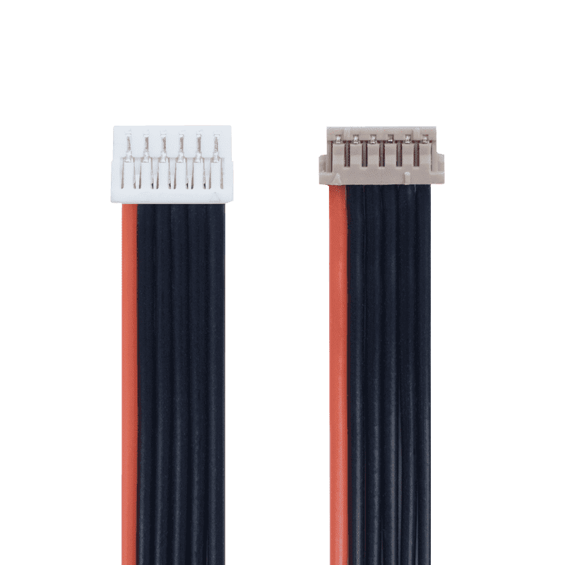

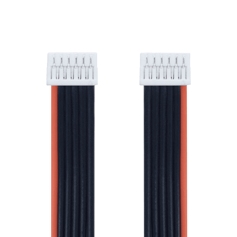

Could you integrate Emlids power cable for M2 ? Or maybe or you’re using a USB cable for power ? I started building a drone kit about 2 years ago but gave up due to work and instead bought an Evo II and also a Matrice 350 with lidar.
This is what Emlid has but are for Pixehawks

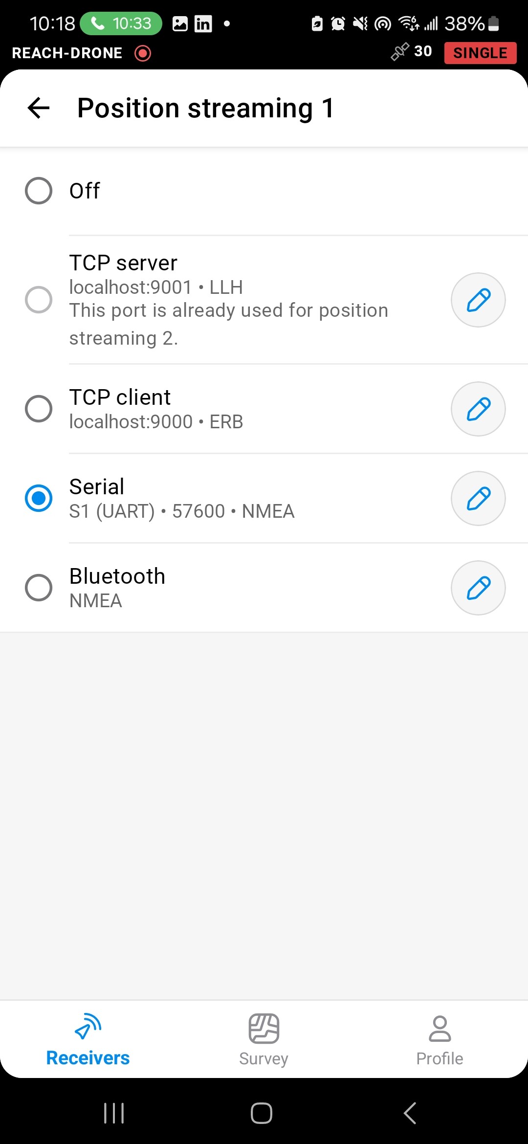

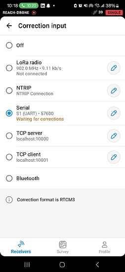

I’m back with some new questions. I noticed on my NTRIP provider that it was only sending corrections every 30 seconds and I think this is what is causing the GPS2 not found error I am now receiving. One of the support teams for my NTRIP provider looked into the logs and said
“I took a look at the log files for your sessions and something I am noting that seems out of the ordinary is that your device is sending us an NMEA/GGA position message every 30 seconds. Different RTK receivers send a message in different frequency and I believe some can be adjusted but I typically see one every 3-5 seconds from most systems. So the fact that you are stating you are only receiving corrections every 30 seconds and that is lining up with our system receiving a position message every 30 seconds seems like a pattern. Is there possibly a setting in your system that controls how often your device is receiving and/or sending?”
Is there a way to change the frequency of the M2 of how often it receives/sends corrections? I think it isn’t sending fast enough, which is causing the flight controller to get confused and think that there isn’t an actual RTK module on it. Does this sound correct?

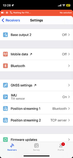

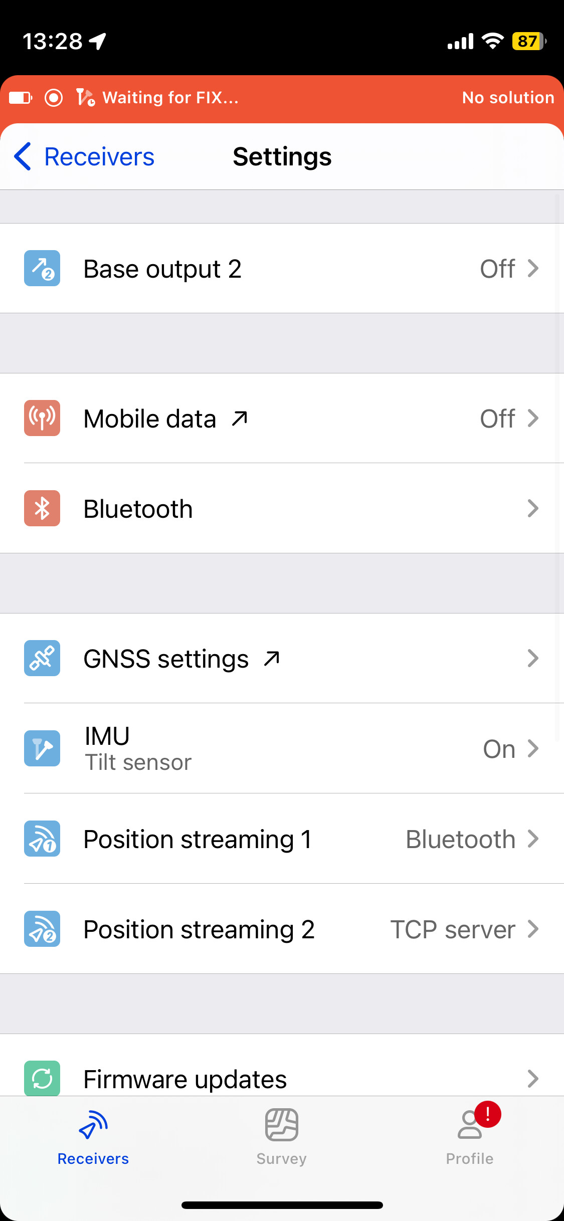

Hi @truettjkerby, you can change the update rate on the GNSS settings, that located on the Settings tab:
