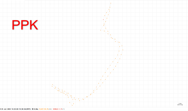

He executes measurements photogrammetric from the ground (not from drone). The method RTK/RTN gives the solution „FIX”. However the method PPK does not give the solution „FIX”.

RTK and PPK are two different processes, so they may provide different results. Speaking of PPK, it can also provide FIX solutions. If the results aren’t good, it’s worth playing with the post-processing settings in Emlid Studio by, for example, modifying the elevation mask or excluding some satellites, as they may improve the final solution.
Can you please also share your dataset with me? I’d check what may cause this result of only FLOAT solutions. You can also email it to [email protected] as it may contain sensitive information.

PPK can provide a FIX solution, even with the default settings, for good-quality raw data logs. I’ve checked your data and noticed that the rover’s logs contain some cycle slips and several satellites have lower SNR values. These may result in having not only FIX solutions after the post-processing.

I will remind that he executes measurements photogrammetric from the ground (not from drone). Often near obstacles such as the building. That is why my satellite observations, there will often the weak quality.
In the method the measurement RTK/RTN I can see in the real time if I have the solution FIX. That is why my proposal of utilization of journals NMEA would solve my problem.
