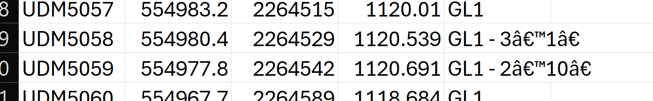

We are not using the built-in codes due to the limitations that are with them, so we are using the description box just like we would with our Trimble equipment.
The issue we are having is when we export certain characters, ie ’ and " marks. The attached image shows what they come out like, and they are supposed to be 3’1" and 2’10"
Any ideas on how to fix this without editing the CSV?

It works for me. I’m using Numbers as I don’t have Excel on my laptop.
Are you using Excel? If so, you might need to manually specify the file’s encoding when importing it into the software. If it doesn’t work, please email us the CSV at support@emlid.com, and I’ll investigate.
