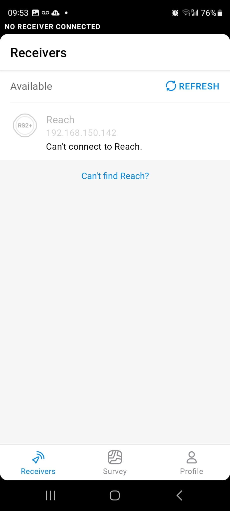

I have configured the emlid using Emlid Flow and the emlid actually works on this router, meaning I can get my rtcm stream from caster.emlid.com over the configures mountpoints etc. When I connect my phone to the same WIFI, I can “see” the IP address of the RS2+, but it never connects. I cannot change the configuration! Trying a laptop in the same network, and the IP address does not give me a webpage at all.
All I can see on the phone is “Can’t connect to Reach” Any ideas???

Let’s place both the receiver and mobile phone closer to the router, and check if it helps.
What is the network you work with? I just see that the signal is weak, and most likely, there is no internet.
