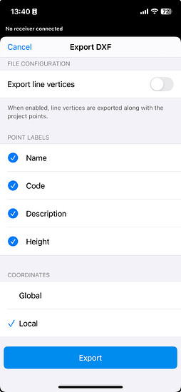

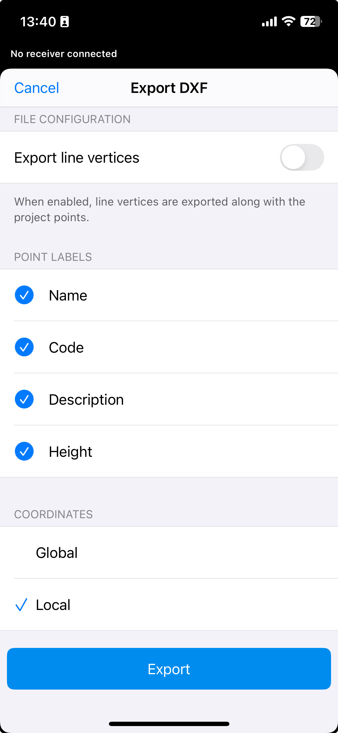

So, when exporting in DXF, it’s needed to choose the local coordinate system on the export page, as seen below.
This is because DXF files only support local coordinate systems, which are in linear units (meters, feet, etc). When exported in a Global, the units are in degrees, but treated as meters. This may explain the distortion and rearranging of points.
