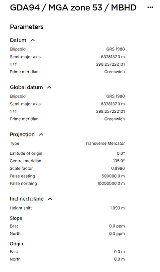

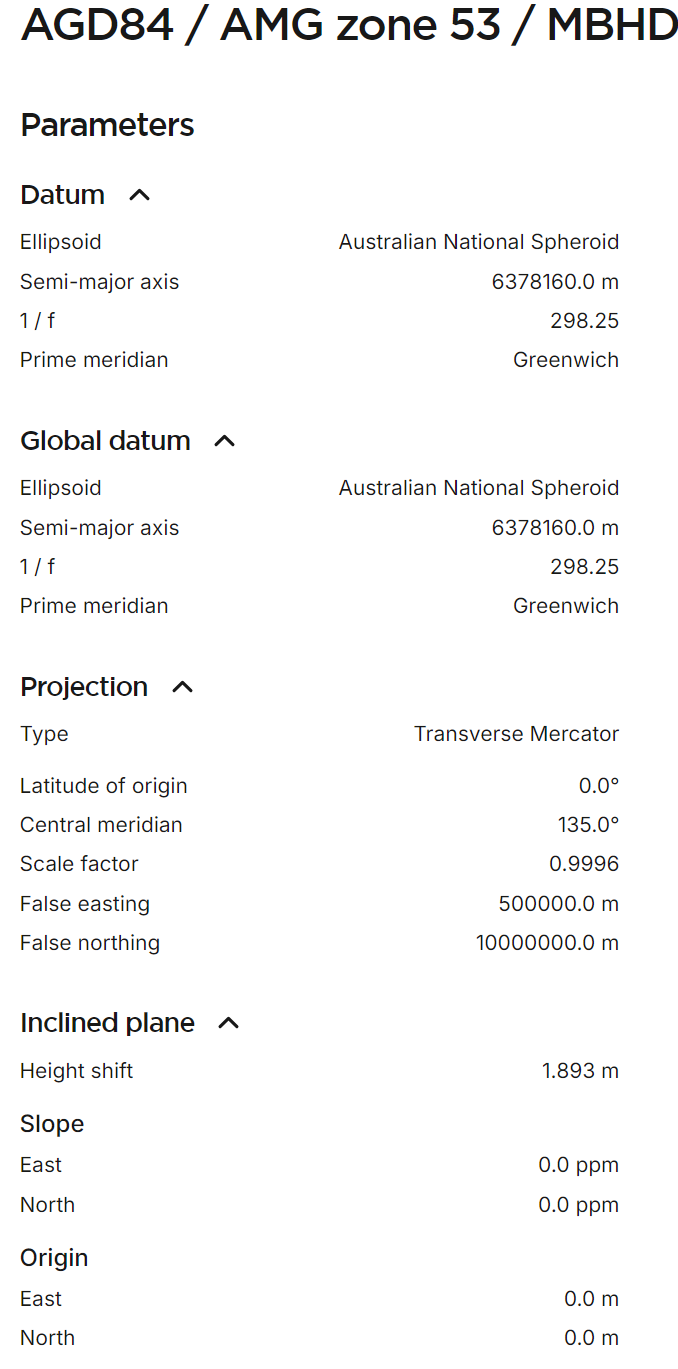

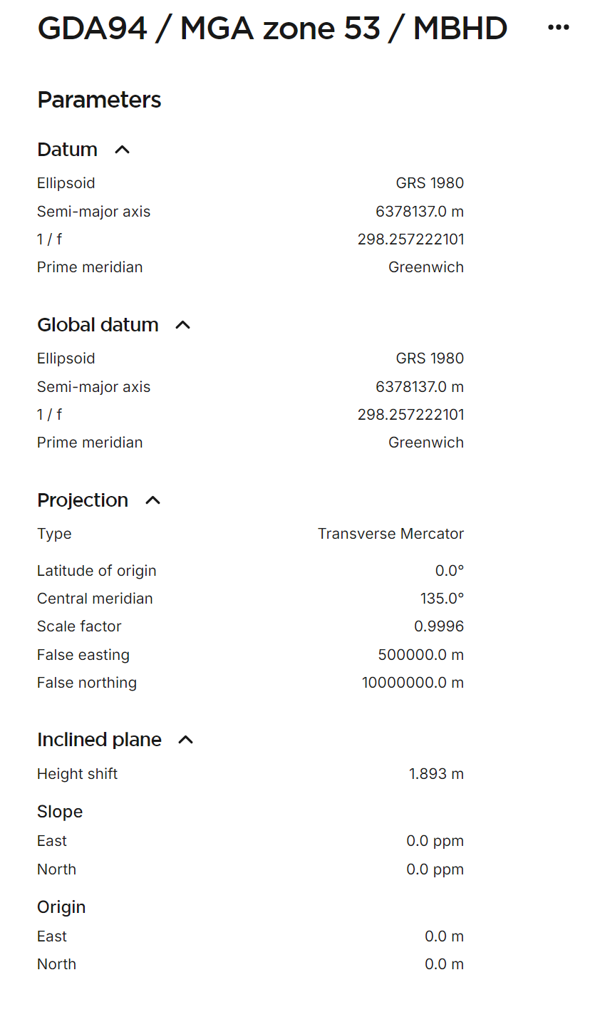

So how can i create a custom coordinate system with a fixed vertical offset?
I have created a custom coordinate system or GDA94 with a vertical offset of 1.893.
When i try to do the same using the parameters for AGD84, the points are not in the correct location.
And if i create a project in AGD84 and try to do site localisation, its doesn’t allow me.
