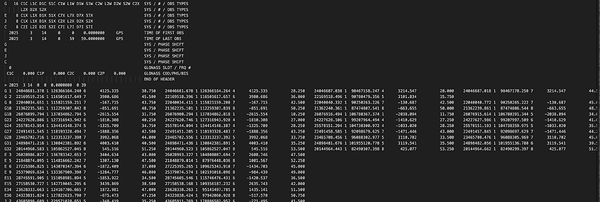

The RINEX file contains raw data from the satellites, including information about each satellite’s pseudo-range, carrier phase, SNR, etc. Here’s a sample of a RINEX obs file.

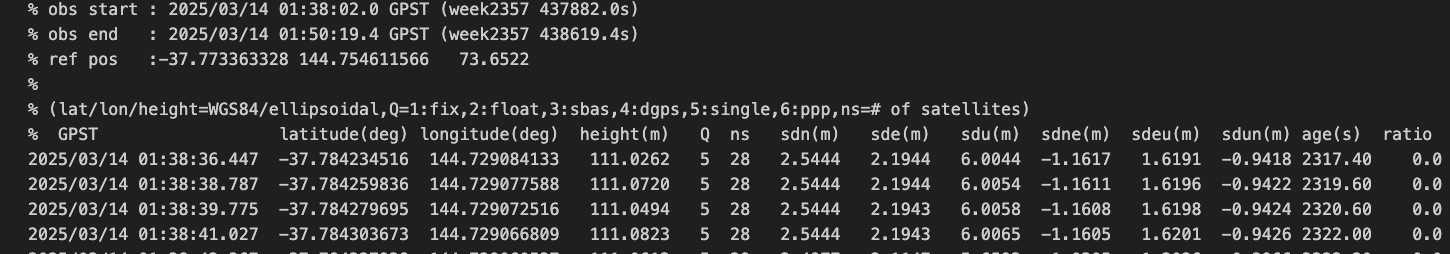

Meanwhile, the pos file contains the coordinates, standard deviation values, solution status, and other relevant information showing the quality of the points.
It won’t be possible to convert the pos file to a RINEX file as it does not contain any information regarding satellites. As mentioned, the .pos file is not raw data but rather a processed file.
