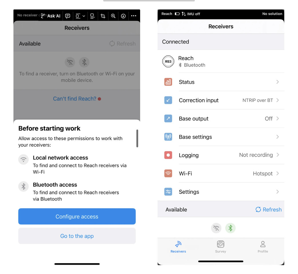

Getting started
  1. Make sure your Reach receiver is running firmware version 32.2 or later, and use Emlid Flow version 12.2 or newer on both iOS and Android devices.
  2. Turn on Bluetooth on your phone or tablet.
  3. Open Emlid Flow and allow location permissions to ensure full receiver functionality. The app will connect to your Reach automatically. If you have multiple receivers, simply tap the one you want to connect to.
Learn more by exploring the step-by-step guides on connection process for Reach RS+, Reach RS2/RS2+, and Reach RS3.

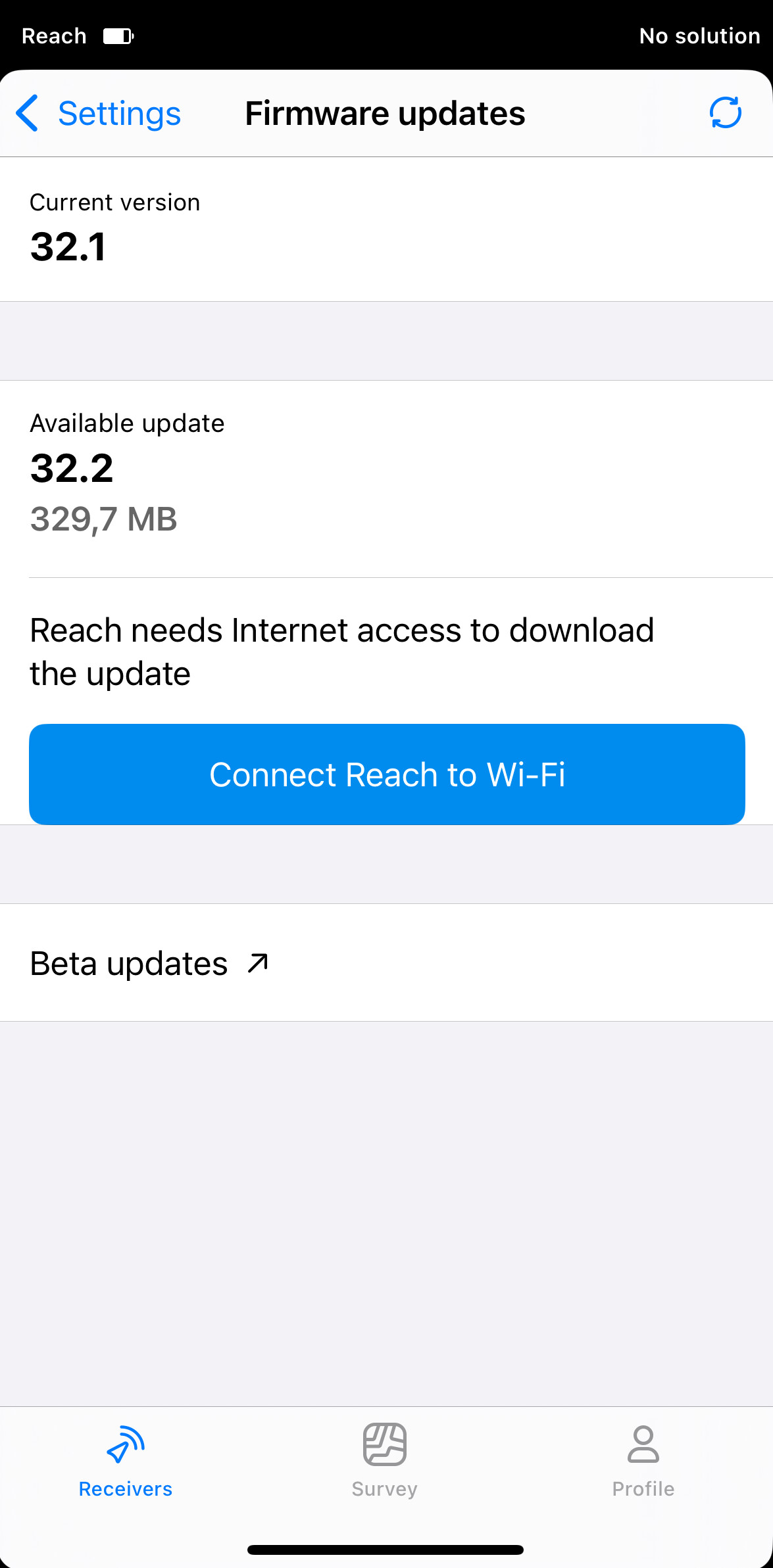

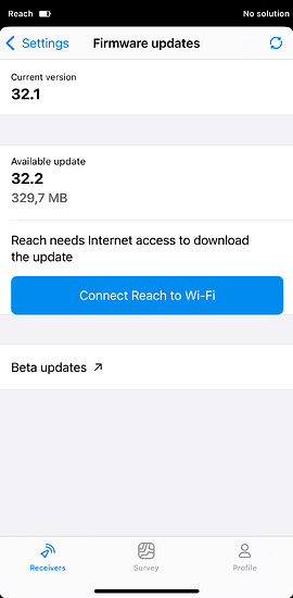

Updating receiver’s firmware
To update your receiver’s firmware, you’ll need an internet connection via Wi-Fi or a SIM card, depending on the receiver model. Thanks to the improved Updater, the process is now easier than ever. Just follow these steps:
  1. Open Settings in the Emlid Flow app.
  2. Navigate to the Firmware updates section.
  3. Connect your receiver to the internet directly from the opened Updater’s screen.
  4. Follow the prompts to complete the update.
Your receiver will be up to date in just a few taps!

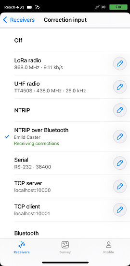

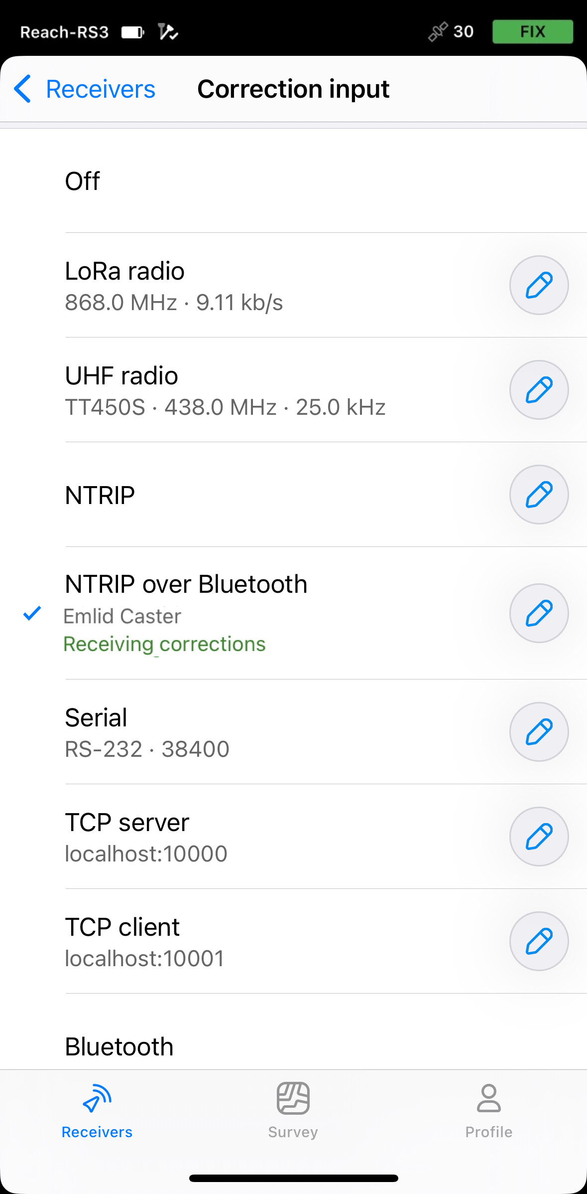

NTRIP over BLE
Since the receiver connects via BLE, your rover can now use your phone’s internet connection to receive NTRIP corrections over BLE. There’s no need to set up a separate internet connection in Emlid Flow. To get started:
  1. In Emlid Flow, under Correction Input, select NTRIP over Bluetooth.
  2. Enter your NTRIP service credentials.
That’s it! Ensure your receiver has a clear view of the sky to start receiving corrections.
If you want to receive corrections on your base and simultaneously stream them to the rover using an NTRIP service, choose the regular NTRIP option. This setup requires your receiver to be connected to a Wi-Fi network.
