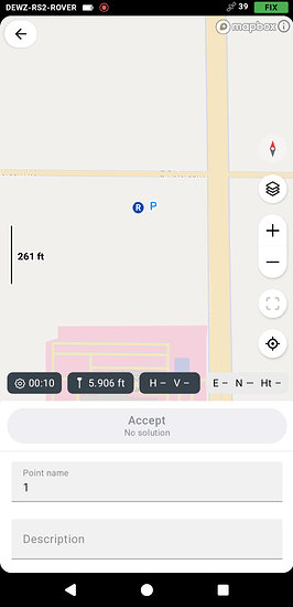

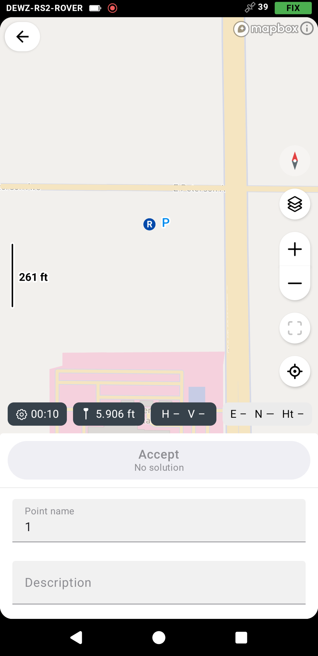

Looking at some of the MCDOT Survey Points it appears they use NAVD88 for the vertical datum. If I select that within a test project, I alway show a greyed out ‘Accept’ button when trying to set a point, with “No Solution” shown under it. This is despite having a FIX.
I’m hoping there is something painfully simple I’m missing that is right in front of me.

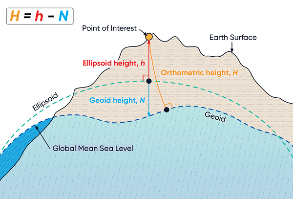

Maybe the difference is the GEOID seperation? Or that may be your Ellipsoid height?

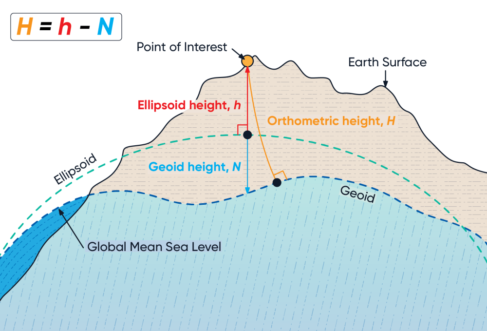

1,423.305’ is your Elevation or orthometric height (point of interest) which is almost 100’ above the ellipsoid.
1,326.360’ is your ellipsoid height.

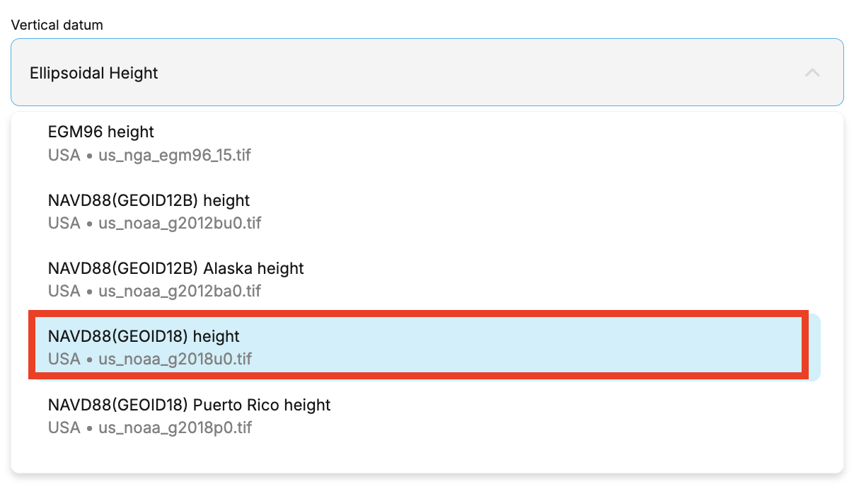

It’s likely that Ellipsoid height was chosen during project setup. If so, you could change the coordinate system of your project by following this guide. After that, Flow will recalculate the coordinates for you.
In your case, please choose GEOID18 from the list.
Also, just want to note that you do not need a survey subscription to change the coordinate system. Thanks!
