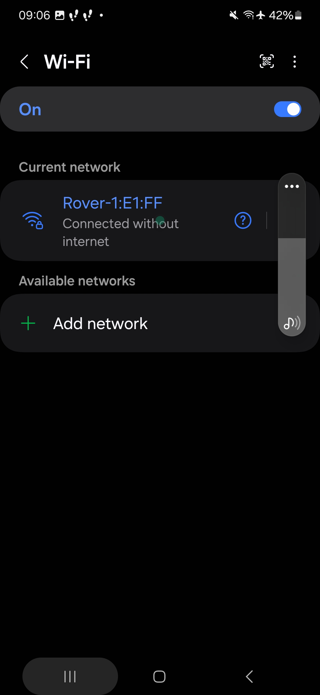

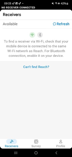

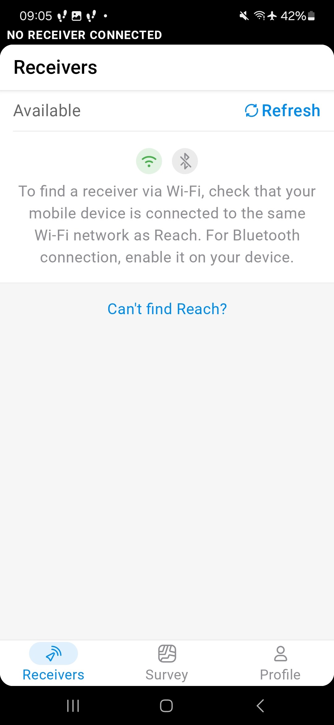

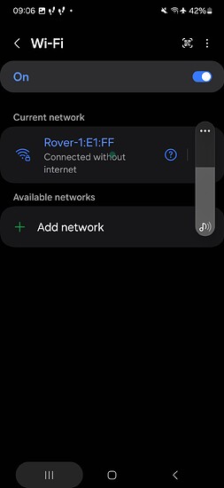

The connection between the receiver and mobile kept being interrupted durin averaging a pont (15 min). The mobile was connected to the Rover Wi-Fi but Emlid Flow couldn’t find the Rover. When it dound it, the connection again dropped during the 15 min recording. I bypassed the problem by using bloluetoth.
The problem resurfaced now when im trying to update the Rover firmware. There is again a problem with the Wi-Fi connection.
Attached pictures from surveying (when I was trying to record points with 15 min averaging and the connection kept dropping) showing how the Rover is connected to Wi-Fi but Emlid Flow can’t find it no mater how many times refreshed.

Make sure the receiver is also ouside in clear sky view or at least next to a window while trying to connect. Mobile device / receiver within hotspot or wifi distance also.

You won’t be able to update the receiver via just the receiver’s HOTSPOT as no internet. Must connect to wifi thatchas internet. Also receiver’s hotspot only reachs a very short distance before it loses connection.
I use Samsung S22. I’ve only used this one with Emlid. I have no issues with the Base, just the Rover. Because of some connection issues I can’t even update the Rover, but had no problems with the Base.
Will see if I can reproduce the issue, at least with updates problem won’t be a problem to reproduce it.
Tried via external WiFi as well, but no avail. Base was no problem, the Rover is acting up …
